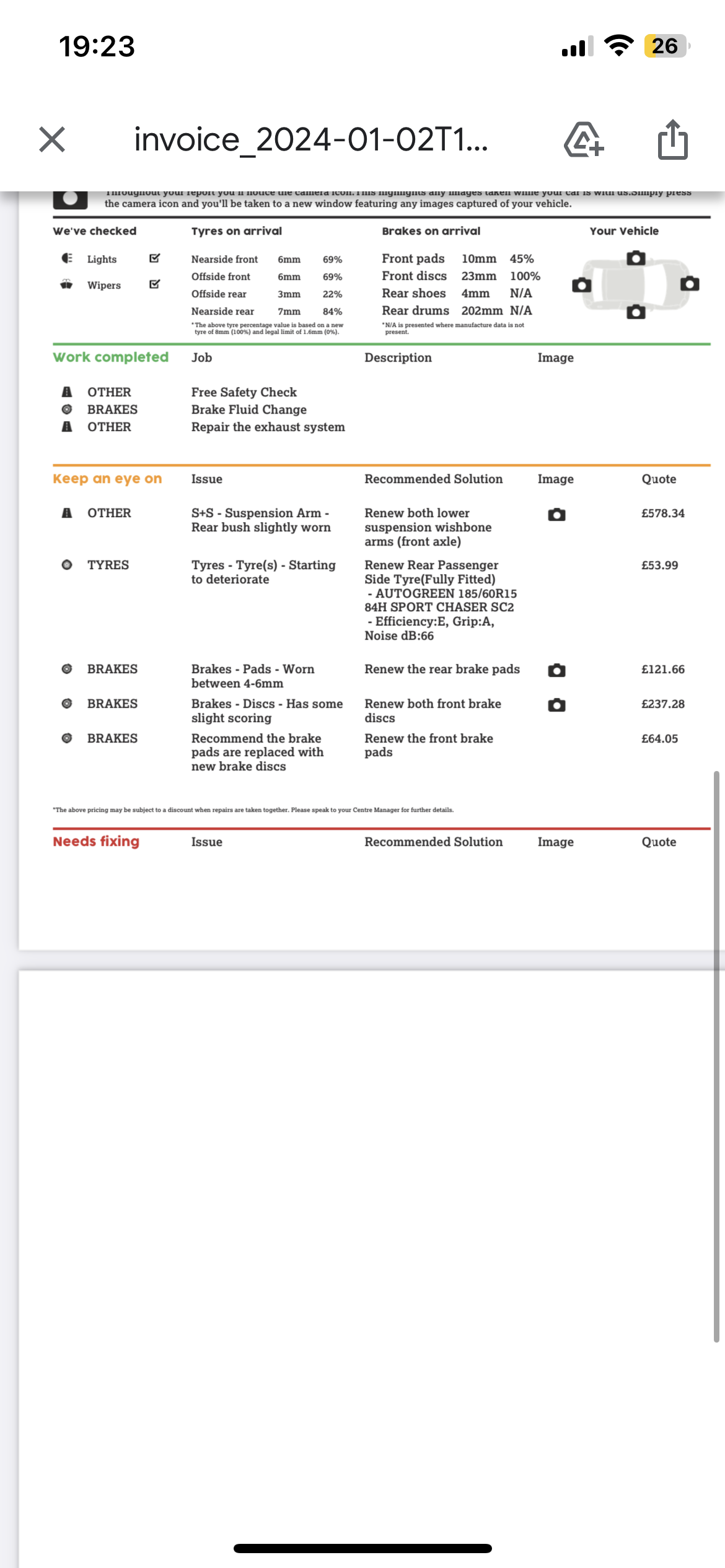

I think it’s solved I took it to Halfords my brake fluid is apparently got oil in it, the exhaust clamp needs renewing and something about my wishbones are close to needing done
its £130 for the clamp and brake fluid change
@Zak13  Beware.   Halfords....
Do you have in writing  'Brake fluid has apparently got oil in it' ?     Question this one, not H20 in it?
Wish bones are something you might want a Mechanic to check and not some Fitter @ Halfords or any tyre and exhaust centre other than if the MOT Examiner.

Yeah he said water and oil don’t mix so I need the change urgently as my breaks will be spongy.
This may be a sign that the (whole) car hasn't been fully and properly serviced in a timely manner as brake fluid changes were/are IIRC at 3-years old then every 2 years after but some owners prefer to test for moisture (water) content and change relying on the testing machine which for some are very cheap Chinese made stuff that may or may not be reliable or others owners simply don't bother even though brakes are THE most important thing on a car.
Exhaust clamp renewed may get rid of some or all of the sound on the video.
I agree that I'd get a 2nd opinion on the wishbones, the car needs to be on a lift with the car's weight fully on the wheels and even then it might get tested to an MoT standard which is a minimum statutory standard and doesn't mean things are good or you won't have noises from there or other places.
From what I've read here and personal experience with my wife's 2016 Fabia Mk3s seem to have a noises (knocks, squeaks, rattles) from under the car mainly noticeable when going down potholes or over speed humps.  Some of these noises never seem to get tracked down despite the owners having lots of work done over a period of time.
That is not to say you have or haven't got issues with your wishbones.
The important things on a car are brakes (always number 1) steering and suspension (all three include tyres, then safety electrics like wipers, lights, horn, etc. (see and be seen) then things like the engine.
If you want to and if there is someone on the list that can help (often for free or beer-tokens) you could ask if they could plug in their scan tool and give you a report from the car's computers and if wanted delete any stored error codes after recording the report to see if any return. - Briskoda VCDS Owners Map (click me)
Final note - do not wait for dash board warning lights, by the time some of them come on you have already left it too late, as much as possible prevent these warnings from appearing by reading the Owner's Manual and carrying out, as required, servicing, maintenance and repairs to the car as a whole and not just the engine.

See this is the report
