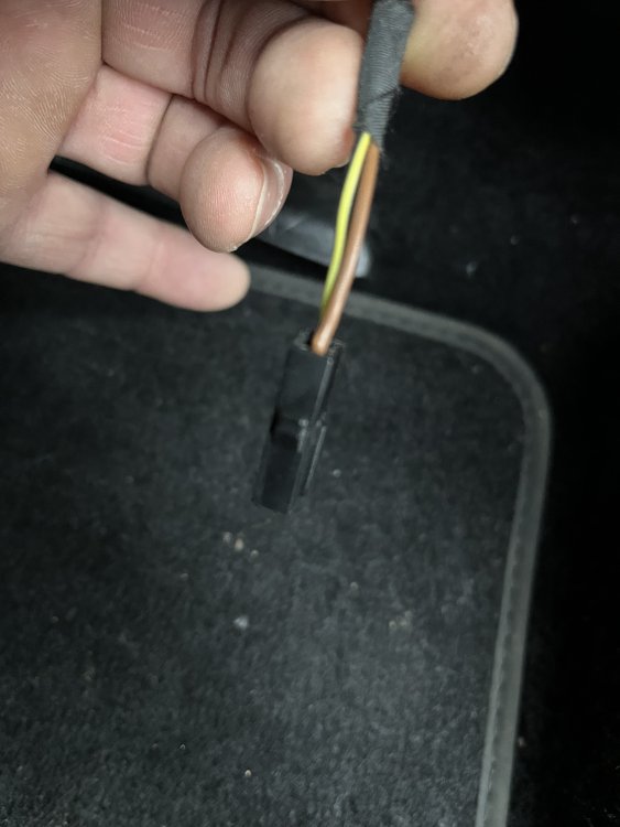

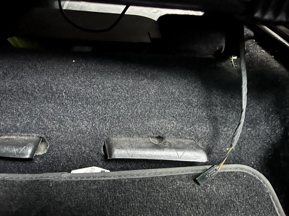

I’ve just recently bought a Yeti and found out the other day that the drivers side seat back doesn’t heat up.
Can anyone tell me if this wire hanging underneath the seat is likely to be the culprit?
I did post on another group but was told that the wire is for a Bluetooth module.
many thanks
Bob
Before I left work today I raised the seat as high as it would go and pushed it forward so I could see where it should be connected.
Plugged it in and the heating element in the seat back started working 👍🏻
