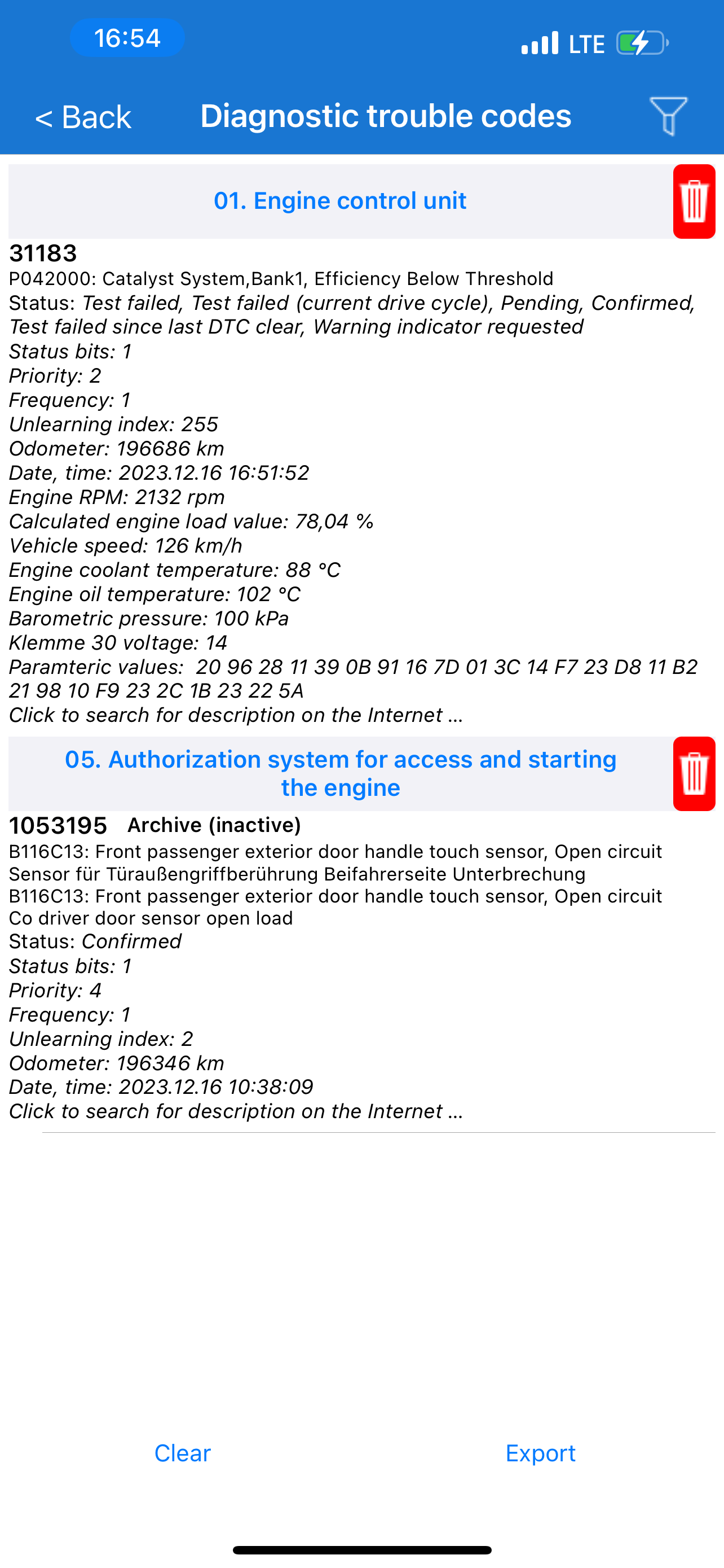

I have a "P0420 - Catalyst System, Bank1" error on my Superb 3 DFCA 2.0 TDI, this issue continues since I bought a car on milage ~184000km
I tried Cataclean, LiquiMolly DPF cleaner and no result
Interesting thing that it appears only during DPF regeneration(passed successfully) and I can't find any similar problem on another diesel cars (like Passat, Octavia, etc.)
Lambda probe sensors are located on DPF and after, I'm a bit confused what to check?
Need some recommendations how to fix/find it
Thanks
Checked both CATs after DPF and on the top of DPF, all good. Have no idea what to check next
