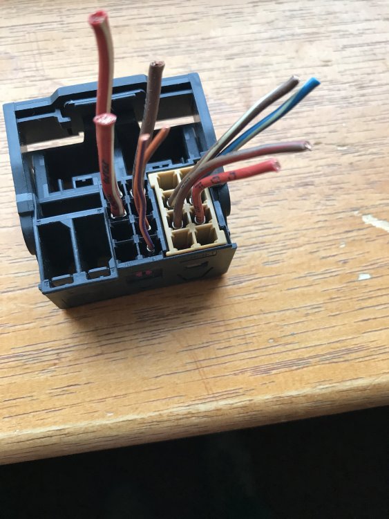

My car has an ‘upgrade’ that is of little use to me! Would prefer to revert to Bolero multi cd unit. For now , could someone please enlighten me as to identity of pictured wires. Was thinking brown insert block is speaker wires…Many thanks,Stephen21DC8EA4-A3B6-4732-ACFE-C5ED28AA11A5.thumb.jpeg.279f2e2a20a50b4889cebf6b0b9fbffb.jpeg
Black block is power/ground/CAN.
Brown block is front left/right speakers.
Thank you for that confirmation. What about the thin brown wires?
Did you look at the diagram I posted? That shows all the wires on your connector...
From your picture, my best guess of wire colours and functions are.
Black block:
- Big red/white stripe are both permanent power
- Big brown is ground
- Thin orange/brown stripe is CAN low
- Thin orange/purple stripe is CAN high
Brown/beige block:
- Brown/white stripe is front left speaker minus
- Blue/white stripe is front lift speaker plus
- Brown/red stripe is front right speaker minus
- Red is front right speaker plus
