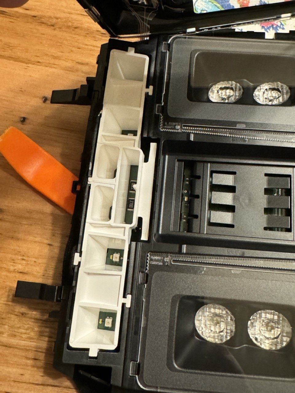

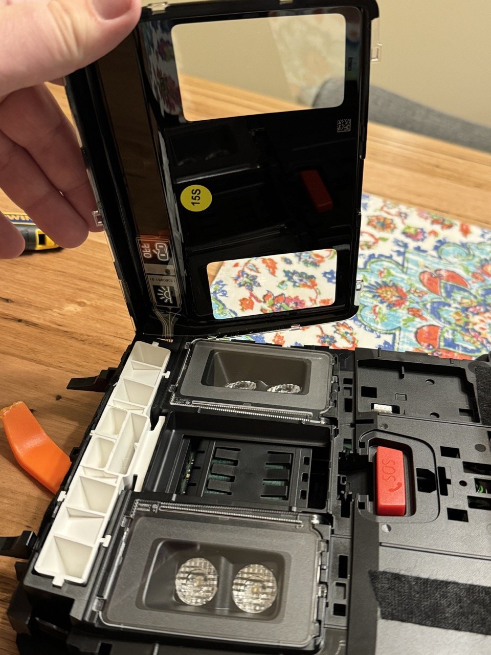

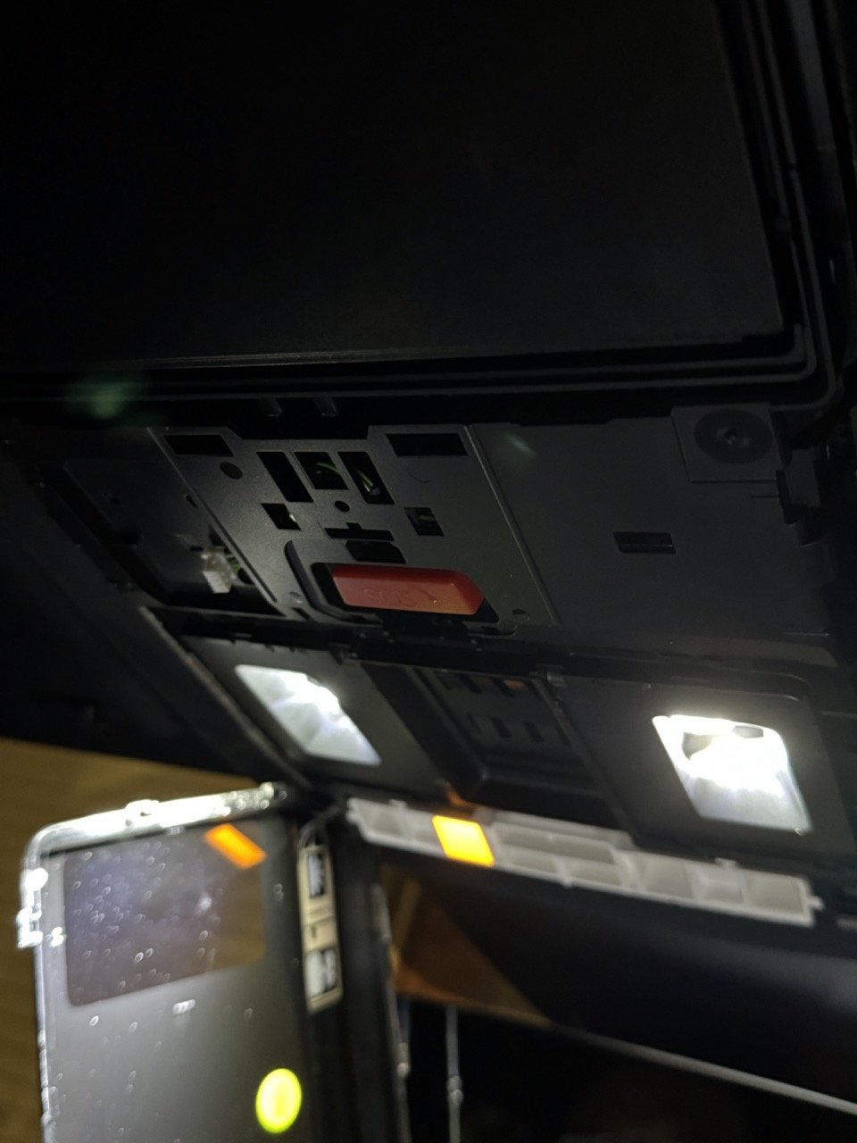

I pulled mine out not that long ago. Accidentally ripped off the fascia panel. But in doing so I found out even cars without Skoda Connect have a hidden SOS button. The microphones are routed through it.
But there appears to be a missing daughter board that allows the SOS button to function - I presume this is the SOS module that all the UK users complain about.
I also took the opportunity to add some tesa tape to sort out the rattles - worked a treat.
