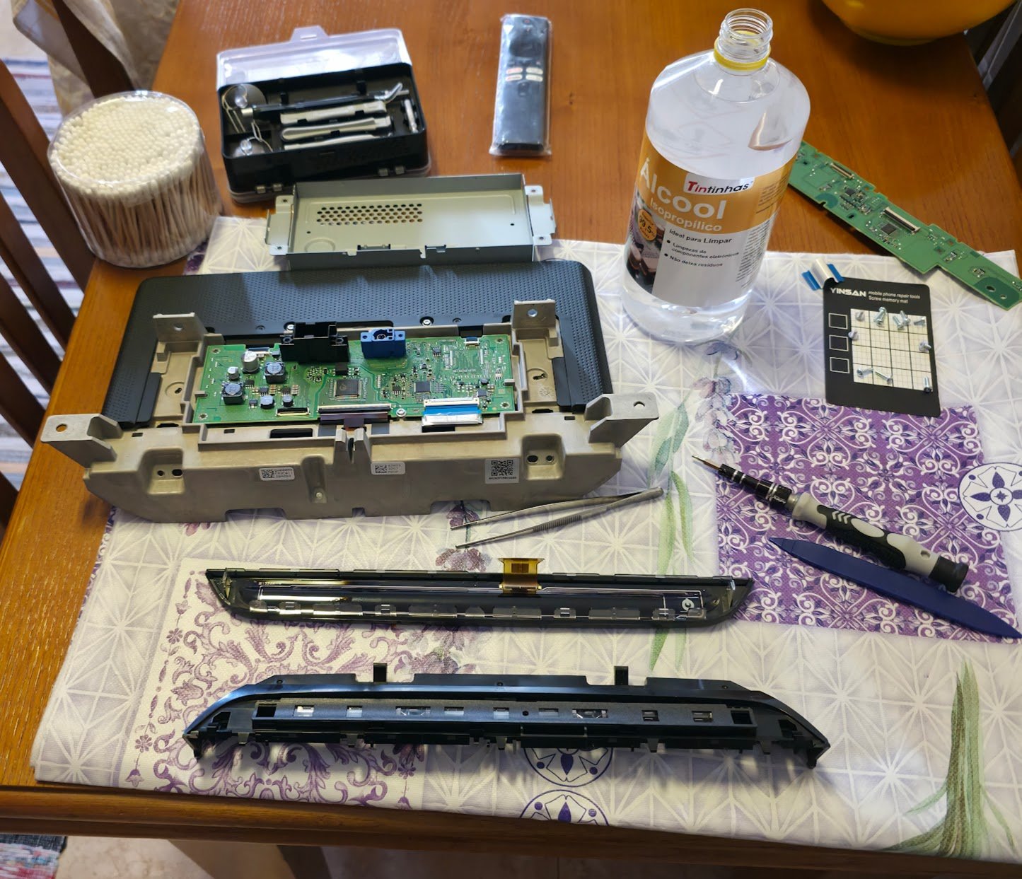

  2. I did, with cotton swabs for the edges, i already reassembled everything and it seems to be working fine, i have to keep checking at night as well when it gets colder. I did turn on the AC with the car running on full cold and it didn't do any ghost touches like it did before. It was a fun day though, was going out for lunch and the car wouldn't start because the battery was low on charge, jumped started the car with my dad's car, the battery charged fine, held charge fine, went to a car shop 30 minutes away, they diagnosed the battery and said the report came out completely fine, so i'm pretty sure it was the infotainment turning on and off during the night and day while the car was parked with the AC and everything. It has to be this because i've noticed that since the power button started acting up, the car wouldn't auto-unlock when i put my hand on the door handle when it was parked for a day. Today was pretty eventful but i hope the problems are over... Kinda wild how it took 5 years for the power button to start going crazy, must have been humidity from the severe winter rains we had
  3. My System started acting up on the volume/power sensor as well today when i went to work. Fun ride to work constantly fighting the screen turning itself off and on again the entire trip. When i came back home everything was normal... I might have to disassemble it to clean with isopropyl alcohol soon

  10. This is something that kinda annoys me, they're made to defog the side windows and no air comes out of them regardless of setting and position
