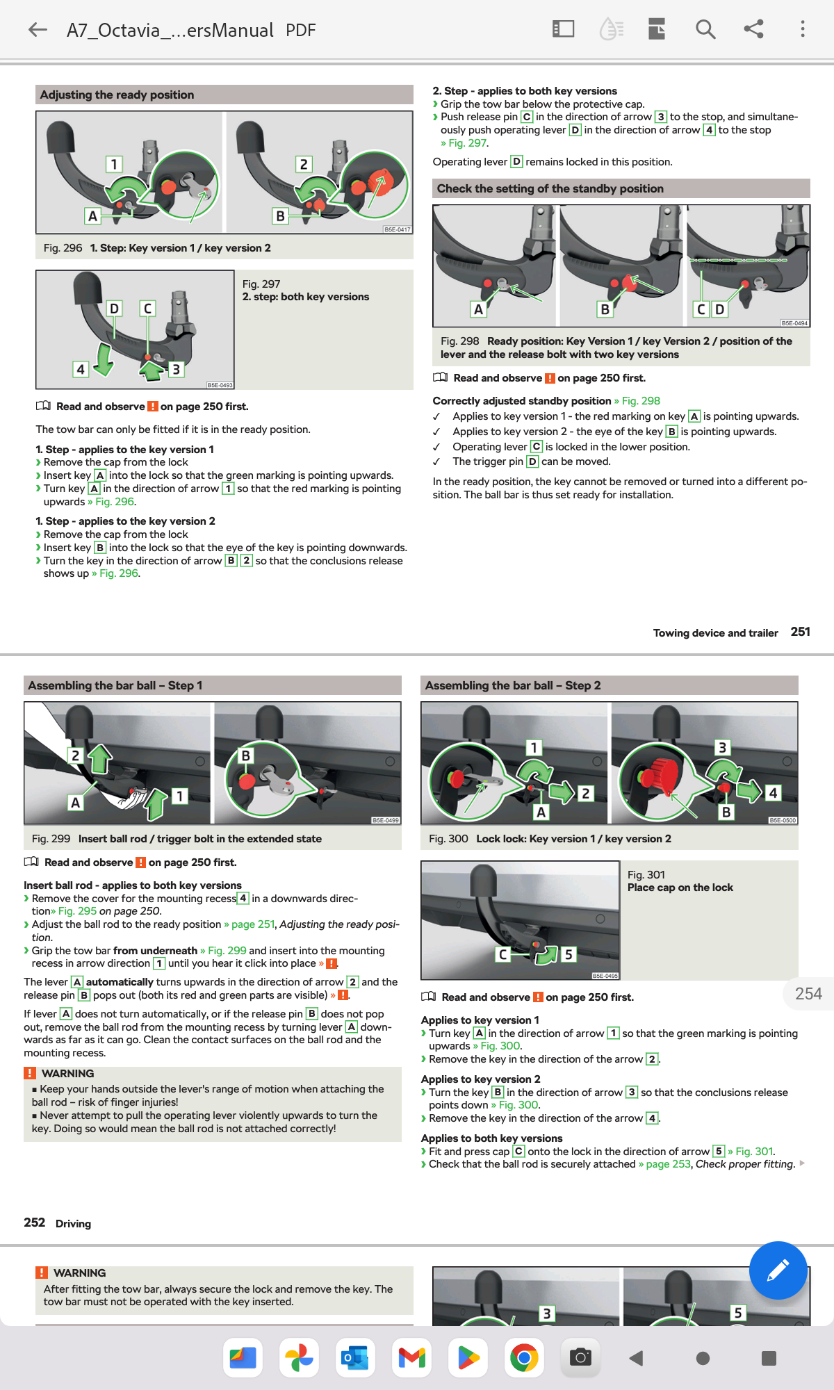

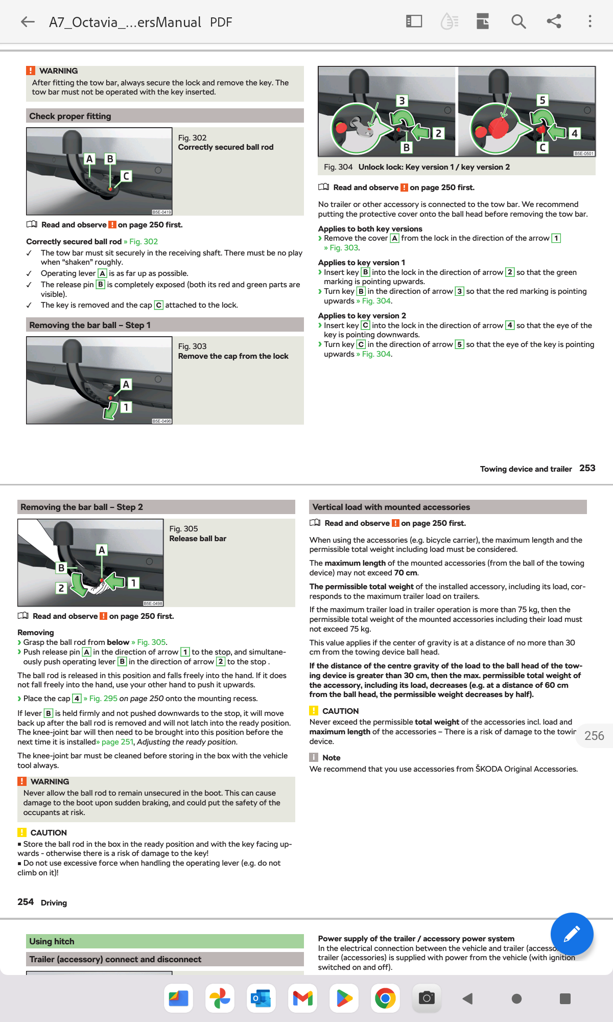

On my Octavia mk III, I have a detachable towbar. Happy to have it, but not so happy I can't get it to function properly. This morning I attached it and detached it, and now the handle won't click back in place.
Any ideas of what to do to get the handle to operate smoothly?
Is the lever with the key in locked in that position? And the key locked in the lever? If so, it's fine, that's how it should be and when you insert the tow hitch the lever pops up and you can turn the lock and remove the key
Thanks, @Cakemonster. You know what, I'll take some time later today to walk through these steps carefully, sitting by the car and then update here with my findings.

Before this thread gets out of hand, I think it's probably fairly potent to say, that... I figured it out once at the hole. It did take a little wiggling, but then suddenly all was well.
There was a second connector - and that worked out too.
Time to close this topic.
Thanks for the tips, @Cakemonster - that did it.
