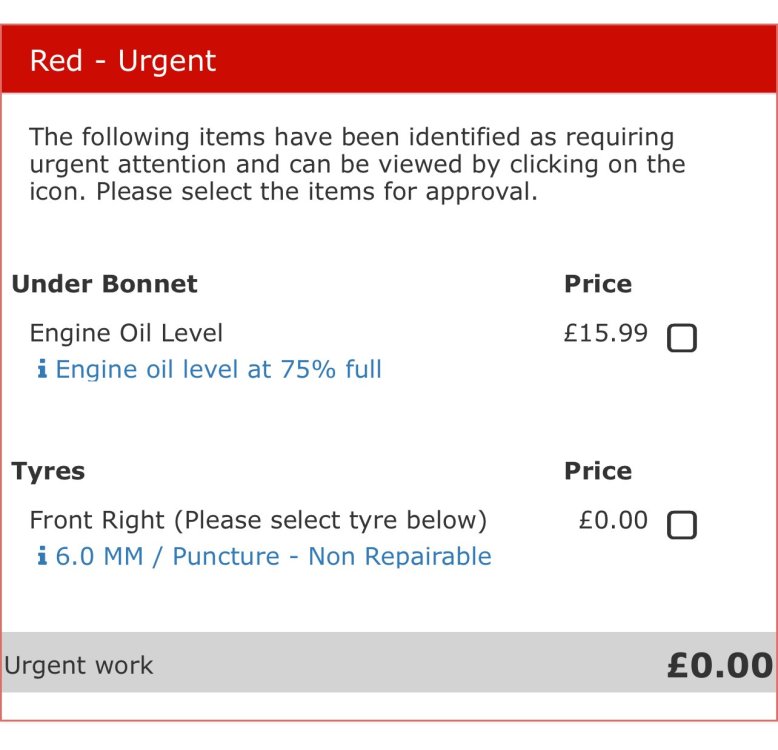

My car is currently in the dealers for work and they’ve sent me a health check email.
It states the oil is 75% filled and needs filled urgently.
I check the oil on my car nearly every day and have never let it go much under the top of the lattice on the dipstick. I keep oil in the boot in case it needs topped up on occasion.
the low oil pressure light has never came on on any car I’ve owned.
It’s too late to call them tonight so what are they on about???

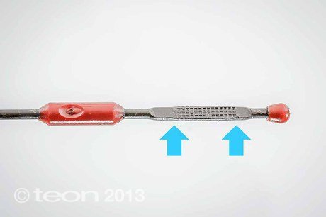

*The oil would be on the bottom orange blob or the flat below the cross hatch area.*
I put 3.9 / 4 litres in the Twinchargers at oil changes as that was what many techs knew was correct.
As for the 1.2 TSI,s and 2012.  Dealerships kept putting in not enough oil at services.  Went by the old quantity, never dipped hot, because cars were not taken on road tests and rechecked when back into the workshop, or parking bay.

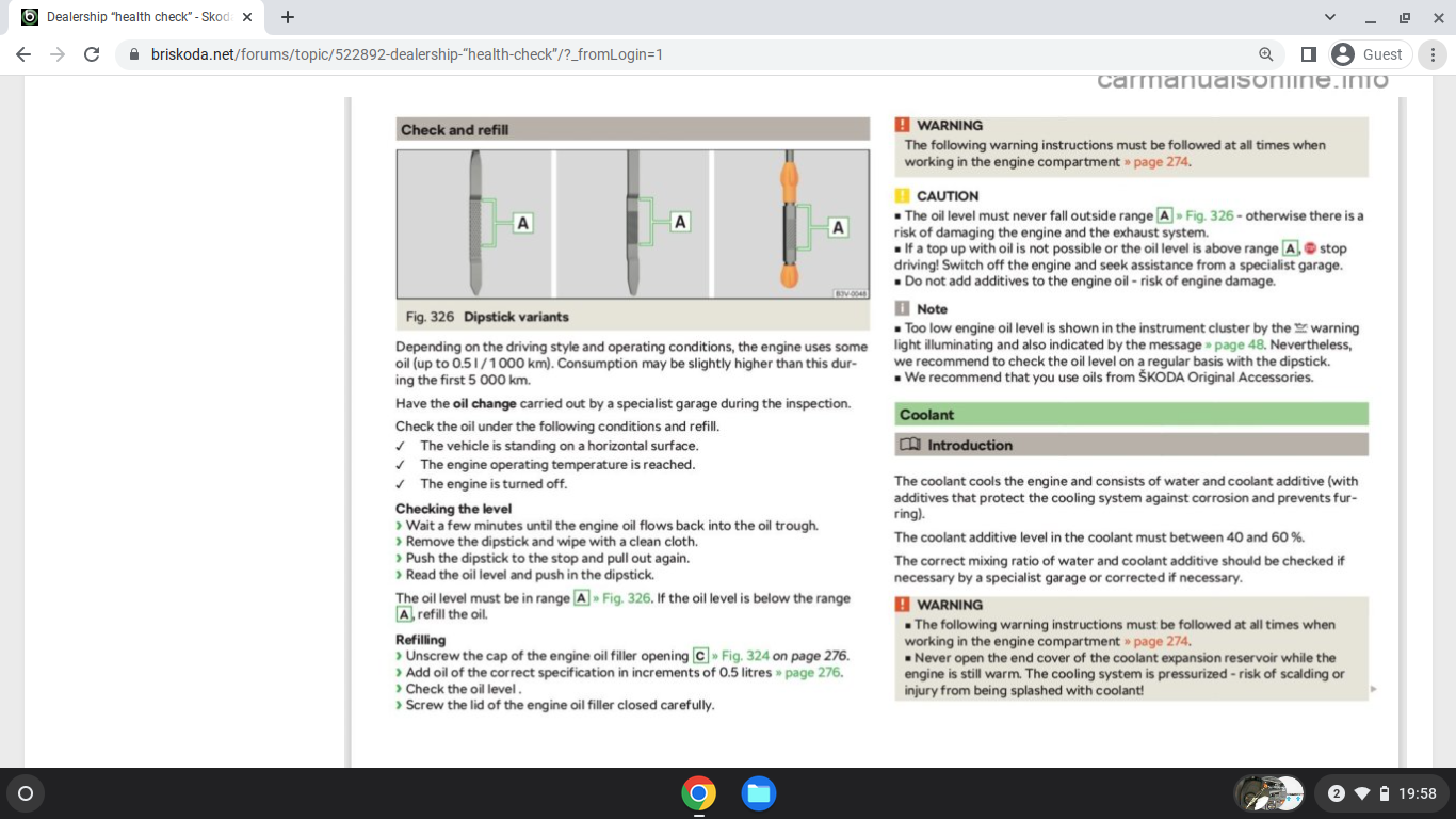

Area 'A' includes the flat above the Cross Hatch.  This is where many make the mistake. Crap dipsticks.

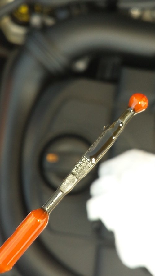

I’ve always checked at operating temp on the flat. Occasionally be topped up a small amount. I checked not long before it went in today. It took a small amount to
bring it up to around 3/4 of the cross hatched area. I checked this 3 times. To be only holding 75% of oil would mean it needs at least a litre which is complete nonsense. Strangely enough a litre is what they’re asking me to pay at £15.99 for.

When you have the car back, dip it cold, and then after at least 5 miles and when an indicated 90*oC.
Normal operating temp.  Compare.      Only 1.2 44kW engines are checked cold and they have only 2.8 litres of oil in.
The top of the Cross Hatch when at 90*oC and stopped a few minutes is the correct level.
Then when it cools see where that is on the dipstick.   Not difficult.

Excellent knowledge but how is the average owner supposed to know all that ? Anyway last time I checked before it went in it was up at the top. I’ve always been told it has to be somewhere on the cross hatch and it’s fine. Last time I topped it up from near bottom of the crosshatch when warm it only took about 200mls to hit the top. Now I’m beginning to think I’ve ruined this engine as it’s a bit noisy under load and at idle. Not terrible but noisier than it should be.
