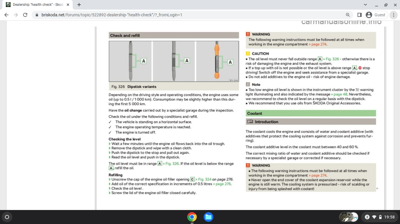

Hi thanks for the reply.
Yes it’s the Yellow oil can not red.
levels look to be good both hot and cold, nothing else looks to be any different it drives well still just the light keeps coming on.
