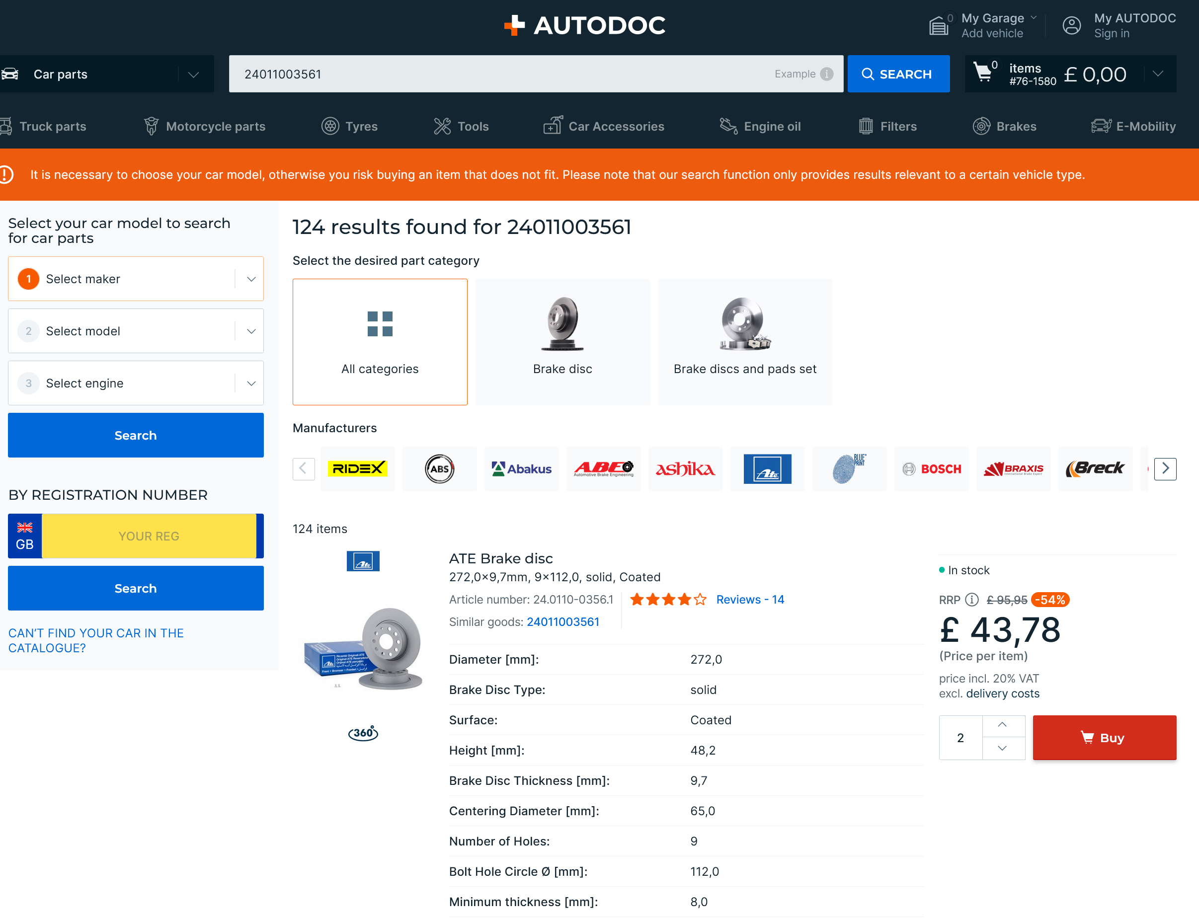

For front disks for my car, I could choose brand TRW, 1KS 272x10mm TRW GDB2042 or brand ATE 1KS 272x10mm ATE 24011003561.
For rear disks for my, I could choose brand TRW, 1ZA 312x25mm TRW GDB1956, or brand 1ZA 312x25mm ATE 24012501581.
I can then go to a parts supplier like AUTODOC, https://www.autodoc.co.uk/ enter the part number, example 24011003561, and get details of the part and the cost of parts associated with that parts number.
https://www.autodoc.co.uk/spares-search?keyword=24011003561
