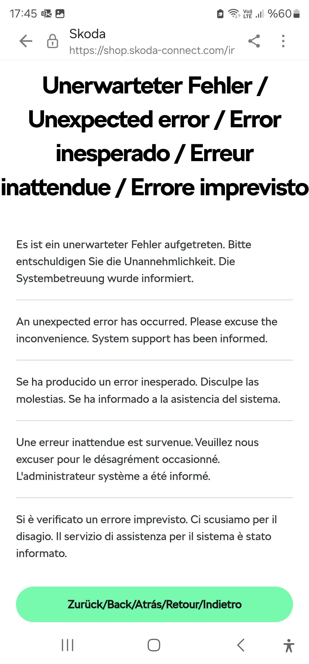

Have you tried to purchase navigation option from HU shop menu? I activated my navigation (2023 Kodiaq) through https://shop.skoda-connect.com/
Screenshot_20240829_174514_SamsungInternet.thumb.jpg.b64af2f772fab3170db95f359cace706.jpg

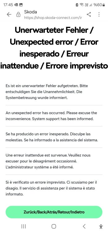

The link you provided is not working
Edited by kosal
Shared Link is not working picture added
It may be location sensitive, it works in Estonia.
