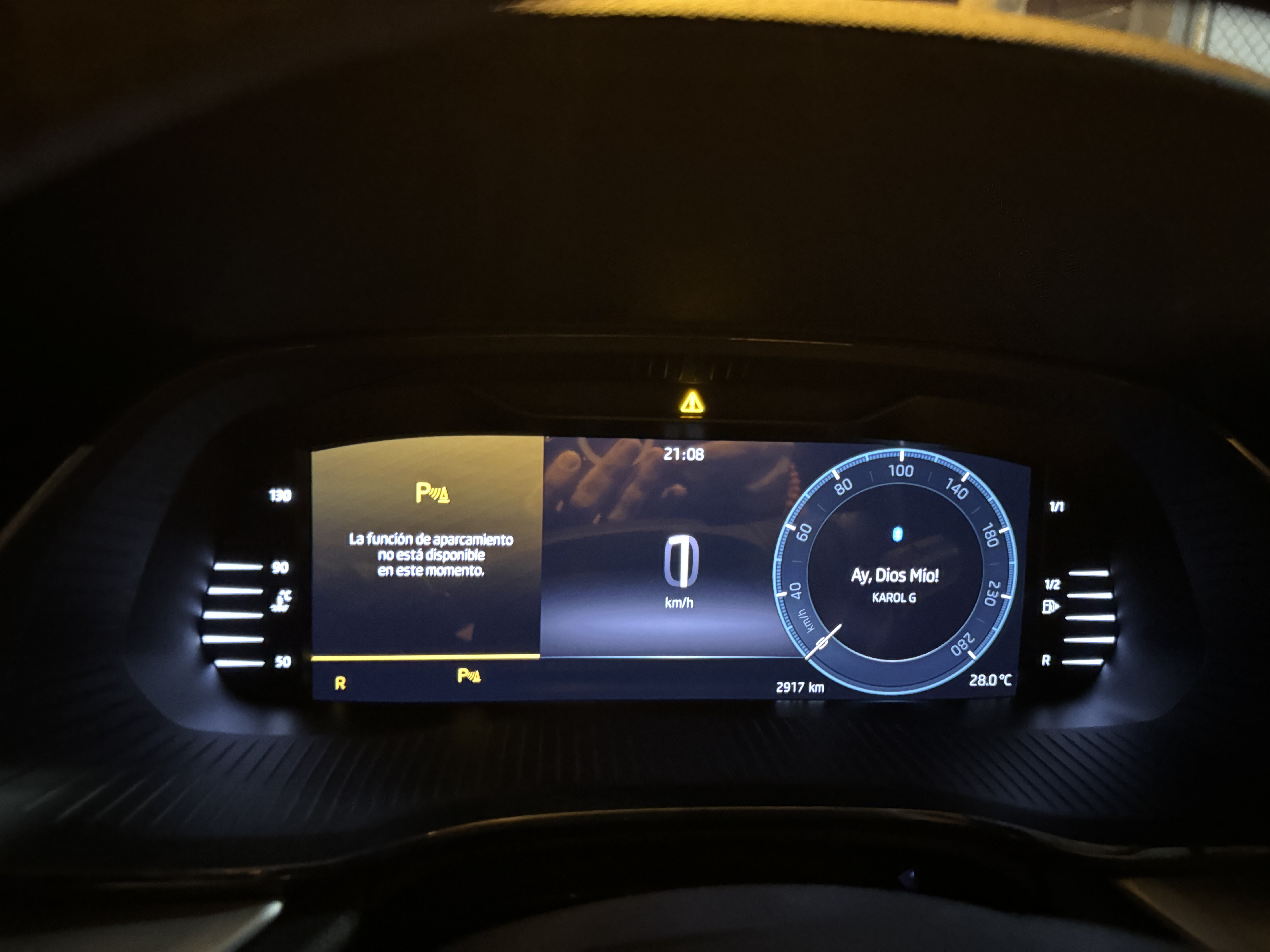

I bought a brand new Skoda Octavia mk4 2024 2.0 TDI 2 months ago. Since I bought it, the car has some problems, like frozen radio, parking system not available, fault in rear lights..
I take my car to the dealer and they said all are ok.. last week, they updated my infotainment, but this problem continues .. sometimes you can use the car and everything is ok; but sometimes, when you put R the problem appears. Yesterday (Thursday 6) I went to the dealer again and scan all my car and they said everything is ok and they “upgrade” my virtual cockpit and parking system…
unfortunately, today the problem appears again.
does anybody have any idea about that??
Pd: the fault appears and after a few minutes disappears
