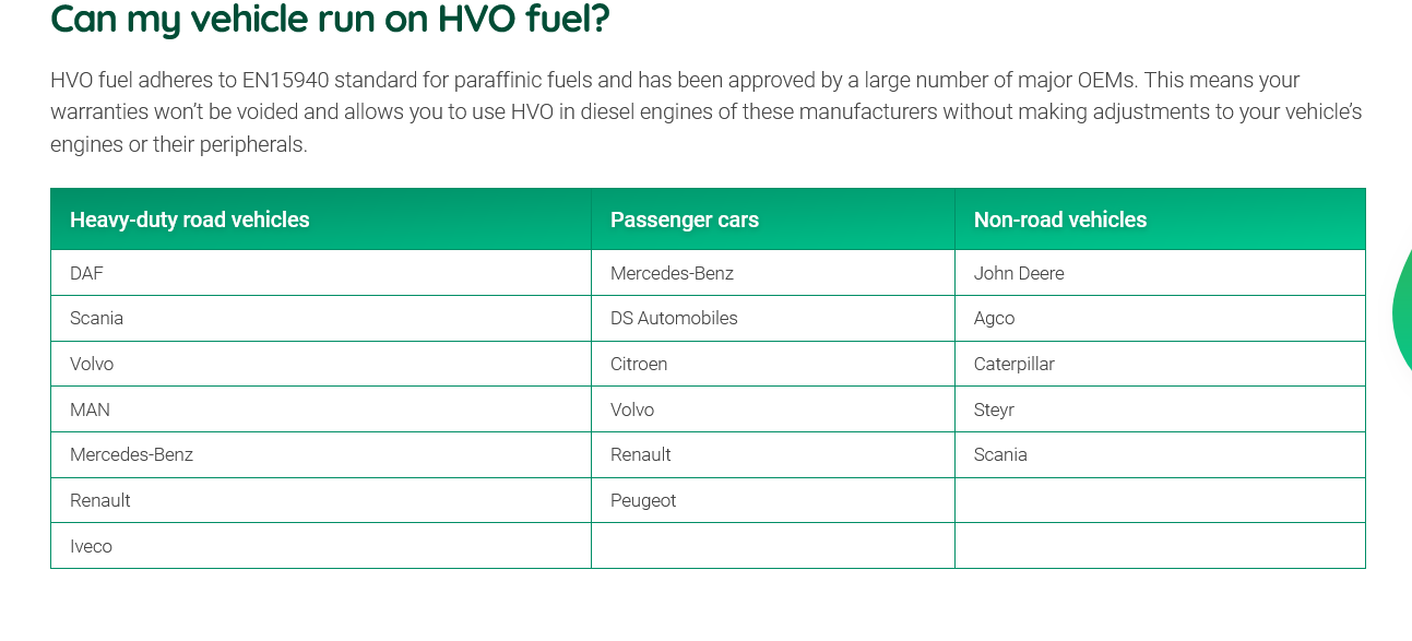

Circle K are promoting BIO fuel for a week.  I run a 2016 model, any reason not to give it a go?

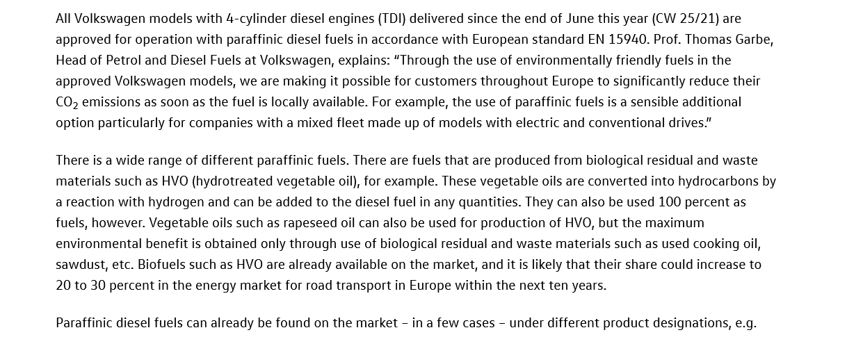

"milesBIO HVO100 stands at the forefront of eco-friendly solutions, presenting an impressive up to 90% reduction in carbon greenhouse gas (GHG) emissions compared to traditional fossil diesel."

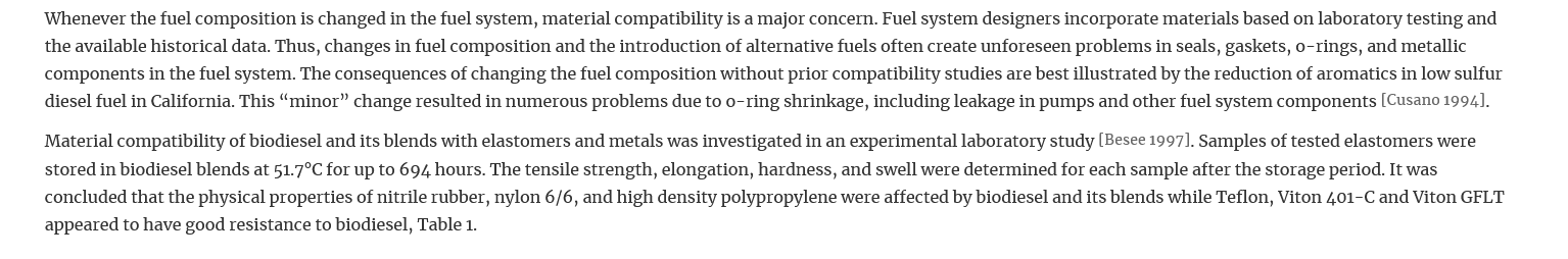

"The vehicle can only be operated with diesel fuel that meets the EN 590 standard"
"All diesel engines can be operated using diesel fuel with at most 7% biodiesel (B7)"
"The vehicle cannot be operated with biofuel RME, therefore this fuel must not be refuelled and driven"

Past experiences of some members on this forum with their dealers and VW's unfortunate recent history with diesels would make me nervous about being an early adopter but if you think it's worth a go I would try and get something in writing from Skoda UK. At least then if something goes wrong you have the evidence for a potential claim. As VW/Skoda are not listed as manufacturers who have approved the use I'd be cautious.
