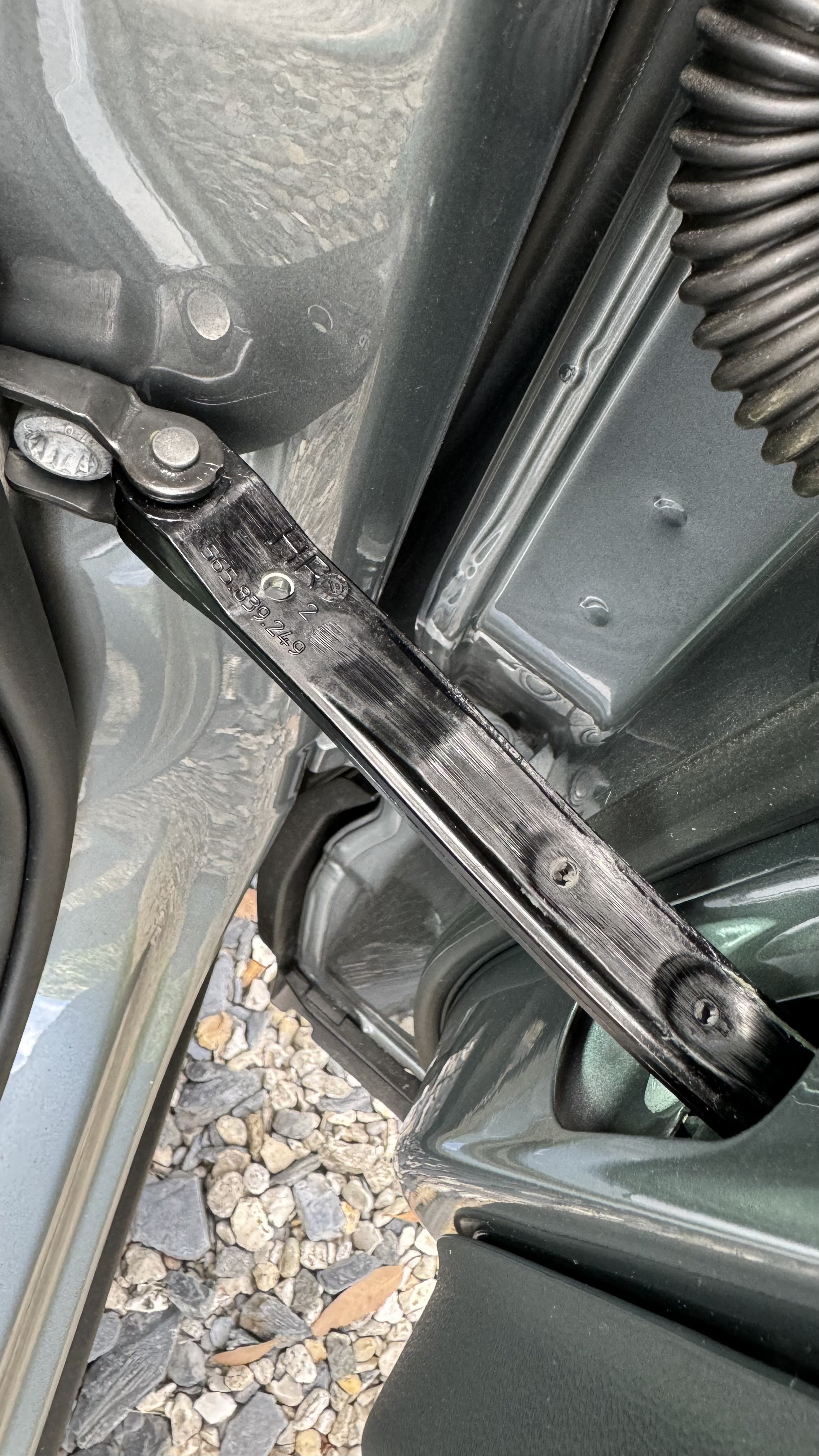

Hi the right rear door feels sort of ok when open , but generally overcomes momentum before it fully shuts, then needs reopening and pushing shut more forcefully. At first I thought this strap thing might have a tension adjustment inside the door? But now wondering if just hinge issue. Any advice please? Also I’m def not a door slammer, so I don’t want to just end up whamming it shut :)
Sorted, I wasn’t expecting much capillary action but a quick squirt of white grease on the hinge gap and also on that tie rod thing did the trick
