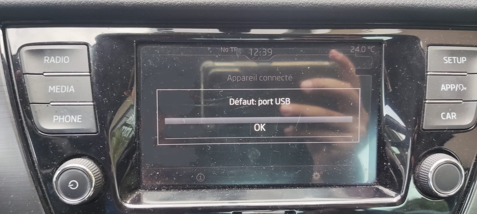

I need help with a problem on my 2019 Skoda Fabia MKIII
I purchased a Wireless Carplay Android Auto 2 in 1 Smart Dongle Adapter
I plug it into the USB port of my swing radio but when I try to connect via bluetooth to the dongle from my smartphone, the Swing gives me an error message and restarts
Has anyone encountered this problem and how to fix it?

for further explanation, here are the steps I follow to connect my phone :
1 - I plug the dongle into the USB port of my swing
2 - then I go to my phone (Poco F3 Xiaomi) and activate the bluetooth
3 - I connect to the dongle that appears in my list of devices (wireless-adapter-2571)
4 - then Android auto launches on my phone and it's at this time that my swing radio displays this message and reboots
using the USB-C cable directly with my phone, no problem launching Android Auto on my swing
Edited by moreteve
Until someone else comes along my first thoughts are -
  • the Wireless Carplay Android Auto 2 in 1 Smart Dongle Adapter might be faulty
  • you are combining  three bits of computer stuff and their programming, any one of those or a combination or permutation of those may not work well together
  • do the ports and plugs go together and are a good tight fit, solid reliable connection
  • are the dongle, phone and Swing radio fully up to date with software updates.
Are you able to test the dongle in another car with another phone to confirm it works properly.
Then are you able to use the dongle with a different phone in your Fabia to see if there is any difference.
Just a possible processes of elimination.
