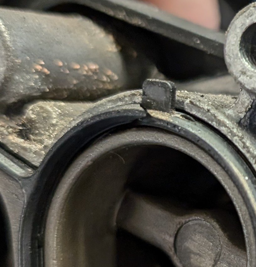

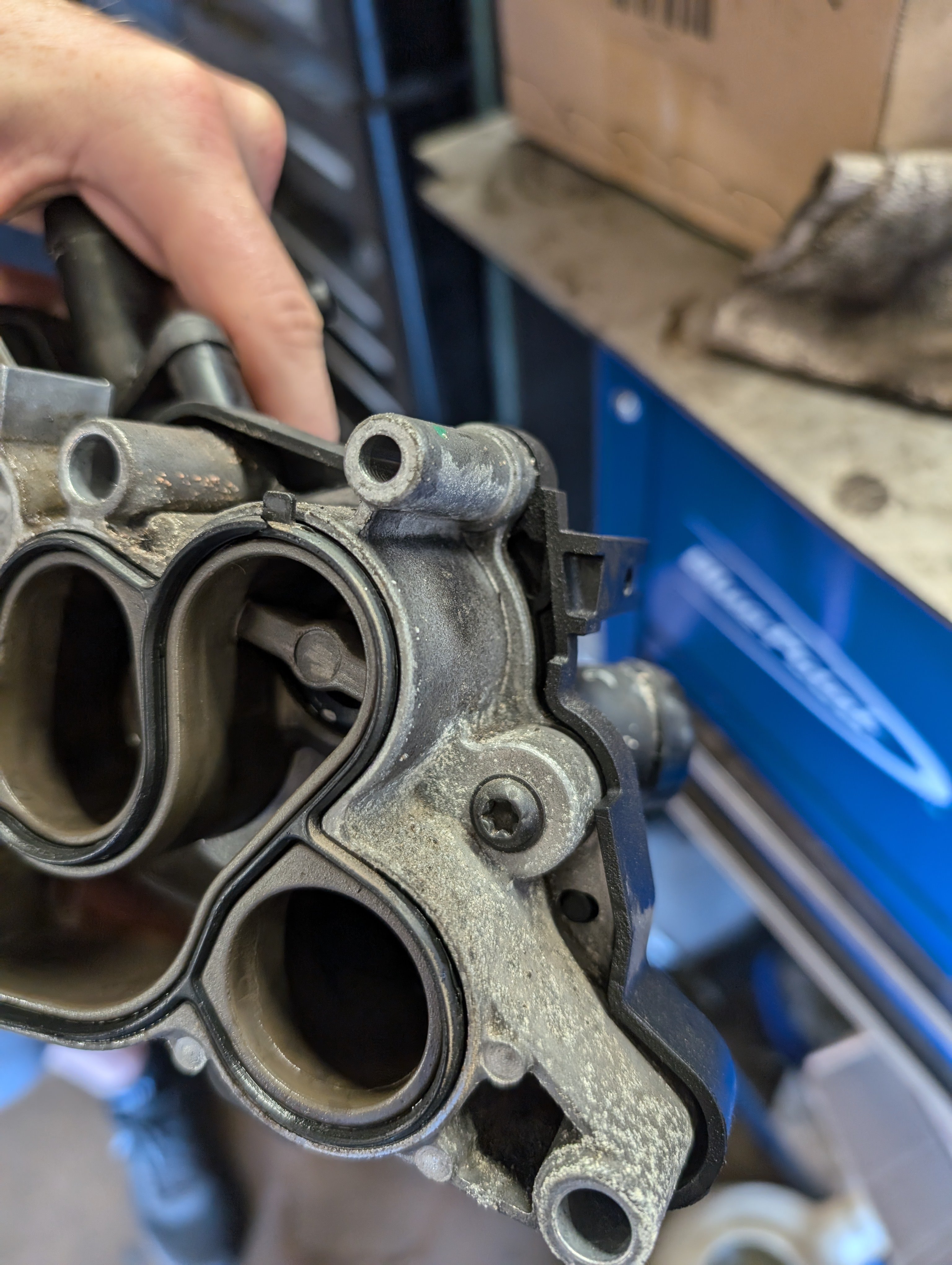

Took it to the garage, and after investigation you could see the gasket had split.
Replaced the water pump and drive belt and all is good .
