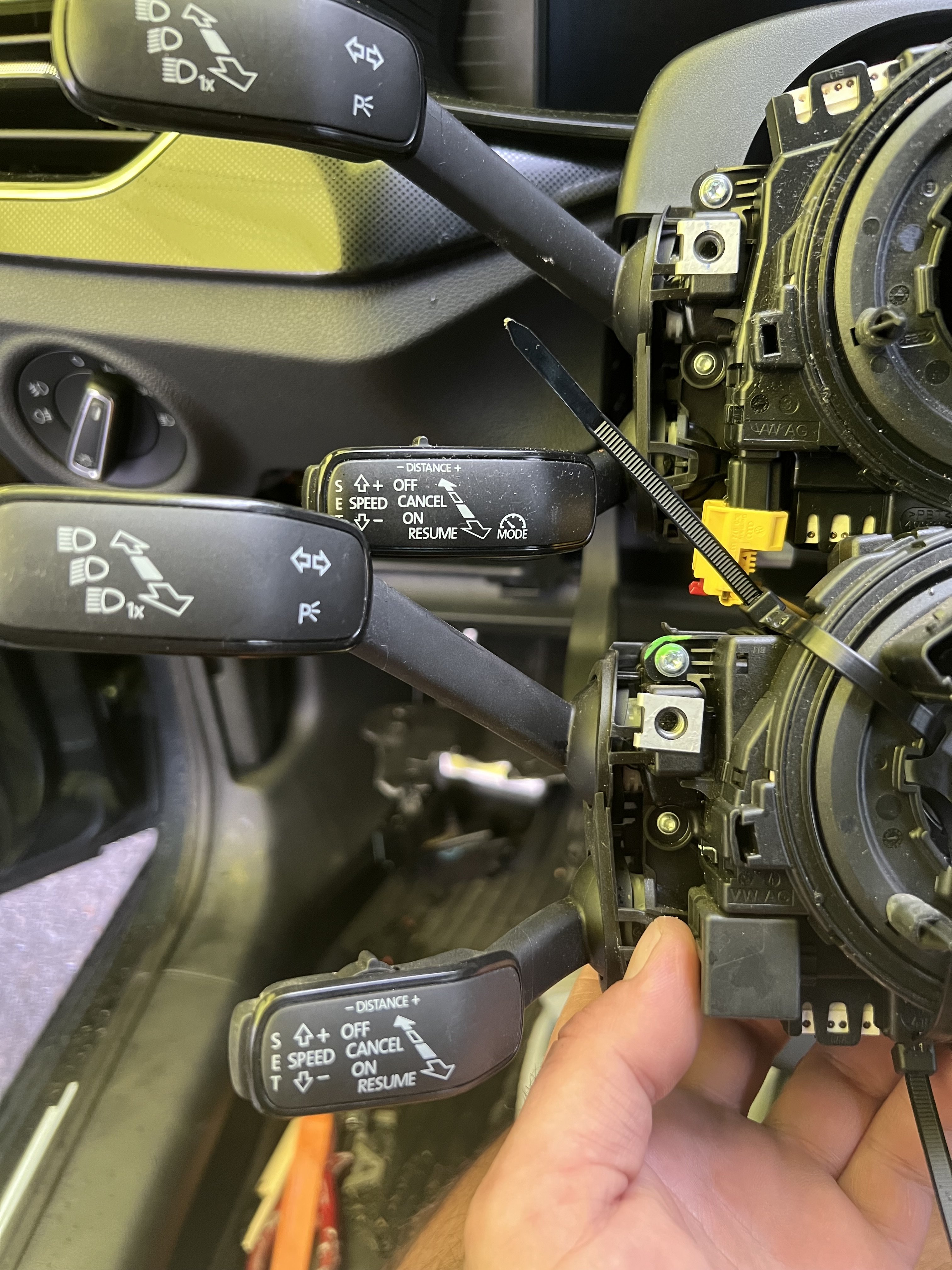

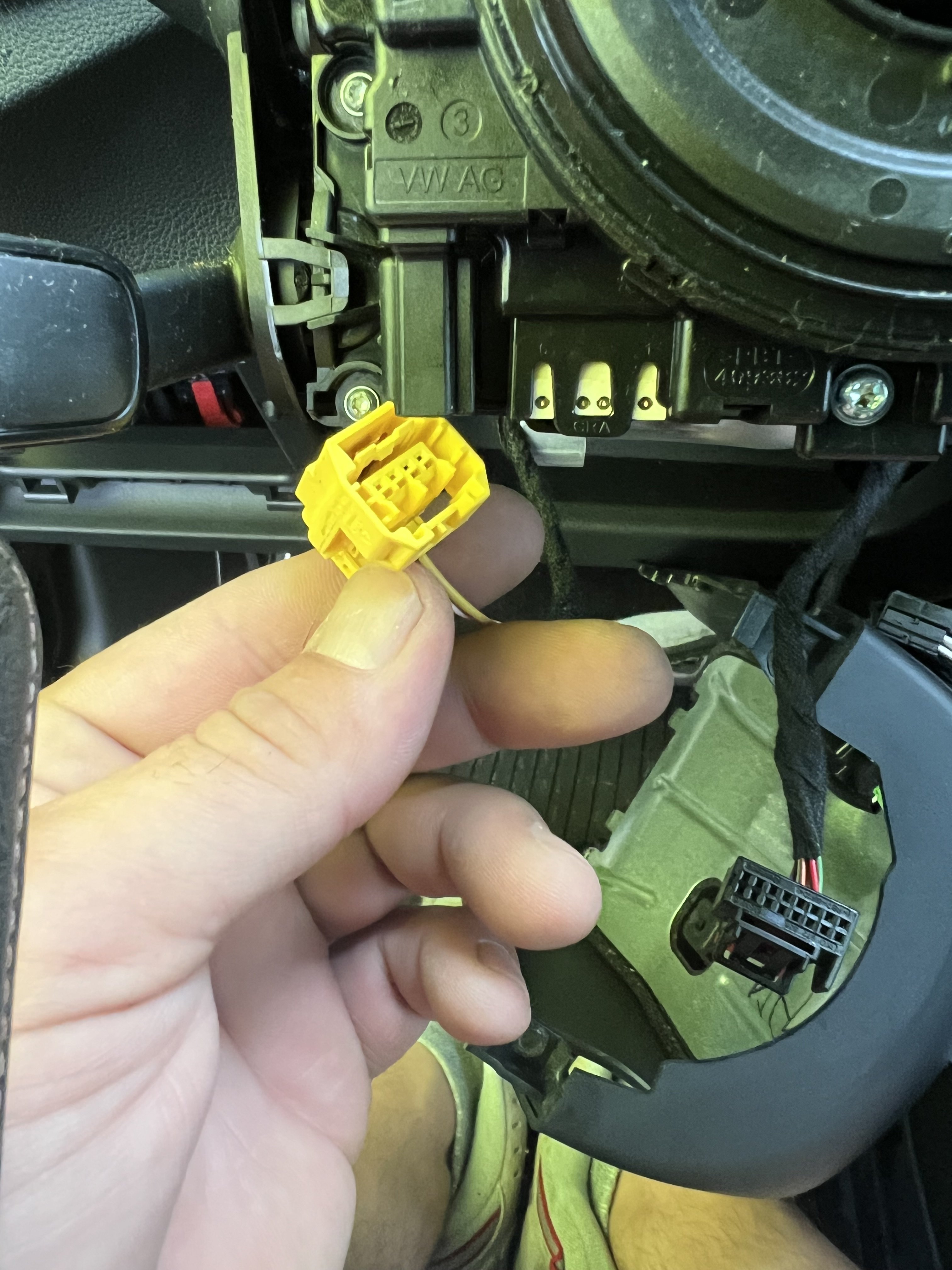

I stuck on my Heated Steering Wheel upgrade. Can anyone tell me where to pin the Yellow Cable? The new Steering Unit has no socket for this cable. You can see on the pictures
Unit 5Q0953561A will replaced with
5Q0953561C
Both, steering wheel and Unit come from Superb Sportline without limiter
steering wheel Old: 5EO 419 091 BT CXA
steering wheel new: 3V0 419 091 AF BGW
Edited by SteffLimitless
EDIT: its 5Q1953561C not 5Q0

Clockspring: 5Q0953561C (B is OK too)
Steering Wheel: 3V0 419 091 AF BGW
Harness from Kufatec.
Just replace Clockspring and Steering Wheel.
Then install the new Harness and connect to a Socket in Fusebox. When you order it from Kufatec they will give a how to link.
Coding in 08 HVAC—Long Coding—Select Heated Steering wheel Gen2.
Coding in 08 HVAC—Long Coding—Set to „Installed“
