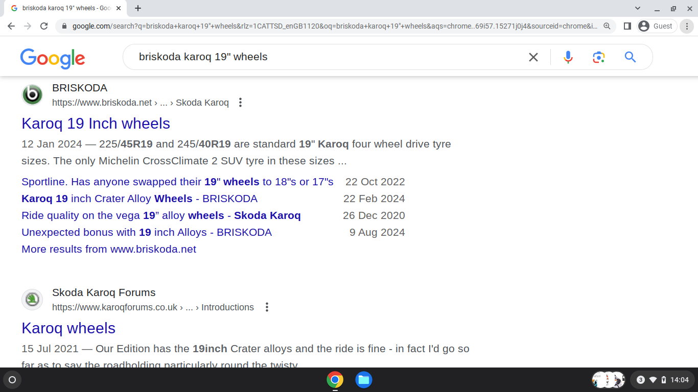

Maybe do a simply search and you will find many similar threads.
