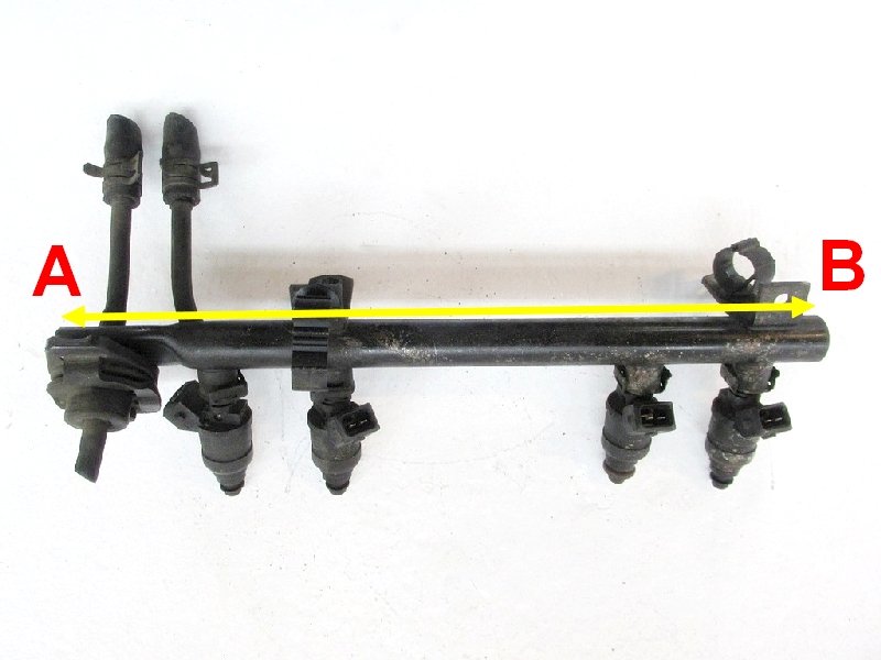

This is a photo of the (injection) fuel rail of Skoda Felicia.
https://www.ekodiely.sk/photos/1/1012695/rijroe49tm.jpg
Since the years as a student have passed long time ago, i wonder: what is the effect of engine bay's temperature on fuel flow?
The gasoline in low or higher temperatures flows or evaporates faster?
Here in Greece we don't have heavy winters but we have quite hot summers, what effect does the rising temperature have on the fuel flow?
There is a pressure regulator, yes, but if with insulation we lower the temperature a little bit in this cylindrical tube, does this have anything to do with the easy flow of fuel to the injectors?
There would be a (even the tiniest) benefit by heat insulating that tube from A to B?
or i must leave it as is because that tube must let cool normally?
There will be no evaporation in the pressurised fuel injector lines.

I used a wrong word, i ment it's better for the fuel to be in higher temperature entering the combustion chamber or not?
By insulating that tube the inside temperature will be one click lower, that's good for the fuel flow or does not matter at all?

As the temperature rise the volume of the fuel does not rise a bit?
In a hot summer day the temperature of the engine bay will rise more so that will affect the flow of the fuel inside the tube or not?
Not in a pressurised system, the pressure will increase according to Boyles law.
The flow of fuel will be a function of the system pressure and the injector orifice diameter, the fuel rail will be sized to not restrict the flow to the injectors.
Dont make the mistake of thinking that 40°c is twice as hot as 20°c, the gas laws and thermodynamics use absolute temperature measured in degrees Kelvin, 40°c (313°K) is less than 7° hotter than 20°c (293°K)
If you really want to continue this you should be looking at the viscosity of petrol vs temperature, you will find that the injectors will flow two tenths of three sixteenths of **** all extra fuel making the mixture minutely richer, at which point the ECU responding to the change in Lambda sensor reading will command less injector duration or rail pressure to lean the engine out back to Lambda 1.0.
In short you will be pi55ing into the wind!
Edited by J.R.
Thank you.
I thought that with less (engine bay) temperature on the fuel rail the gasoline will be injected one click better and especially in a journey at summer this will affect positive the performance.

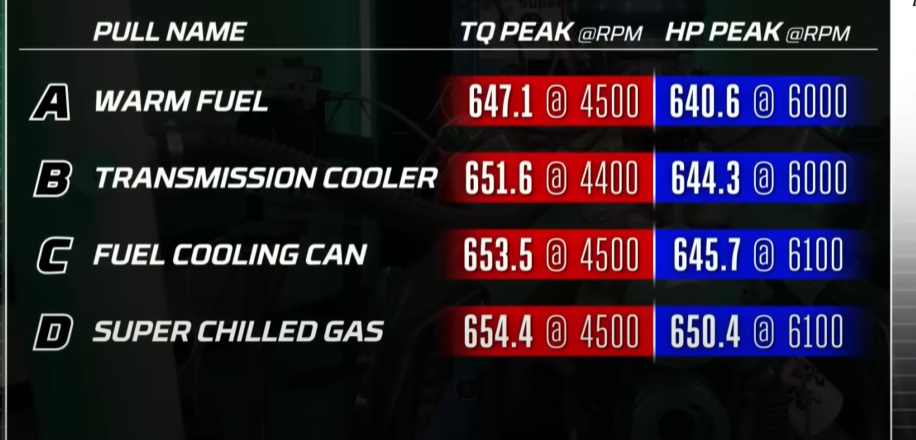

super cool gas has benefits

narrow band m8 only at cruising, super cold gas as it changes phase it sucks heat from the surrounding environment thus cooling the charge and in turn the cylinder
So yes I was right once again the colder the fuel (on a warm engine) the more power you get.
Every 5C or so you seem to be getting around 1hp worth

no, it will be at ambient, heck, there is going to be a point before the retail heat soaks that the performance is going to peak.
fully warmed engine and as cold as it gets gas
Yes but except heat-shielding the rail tube what else can we do about it?
12 minutes ago, Thefeliciahacker said:
In 8:32 of the video.
With the current routing nothing
OK then.
When i find time i will put a heat shield on that tube and ''Case Closed". 🙁
