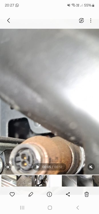

I checked under the steering wheel and I saw that it is disconnected. My question is if I can simply plug it back in.

Hey basically unplugged it. There are two wires that go into the plug. He added a device on one of the wires so it doesn't show a permanent error on the dash. That's as far as I know.

I'd want to get this message understood, and cleared if possible, before doing anything with the knee airbag.
If there's a "device" on the knee airbag wires then that suggests that either there's another fault or the device isn't working properly.
Get a fault code scan done, and understand what's going on before making any changes is my advice.

If it was not faulty, if the "device" is inserted in its place then removing the device with the battery disconnected and plugging the airbag back in should be OK if the airbag was not faulty there is no danger with doing it with the battery connected but that would bring up a MIL light requiring resetting with VCDS or equivalent.
