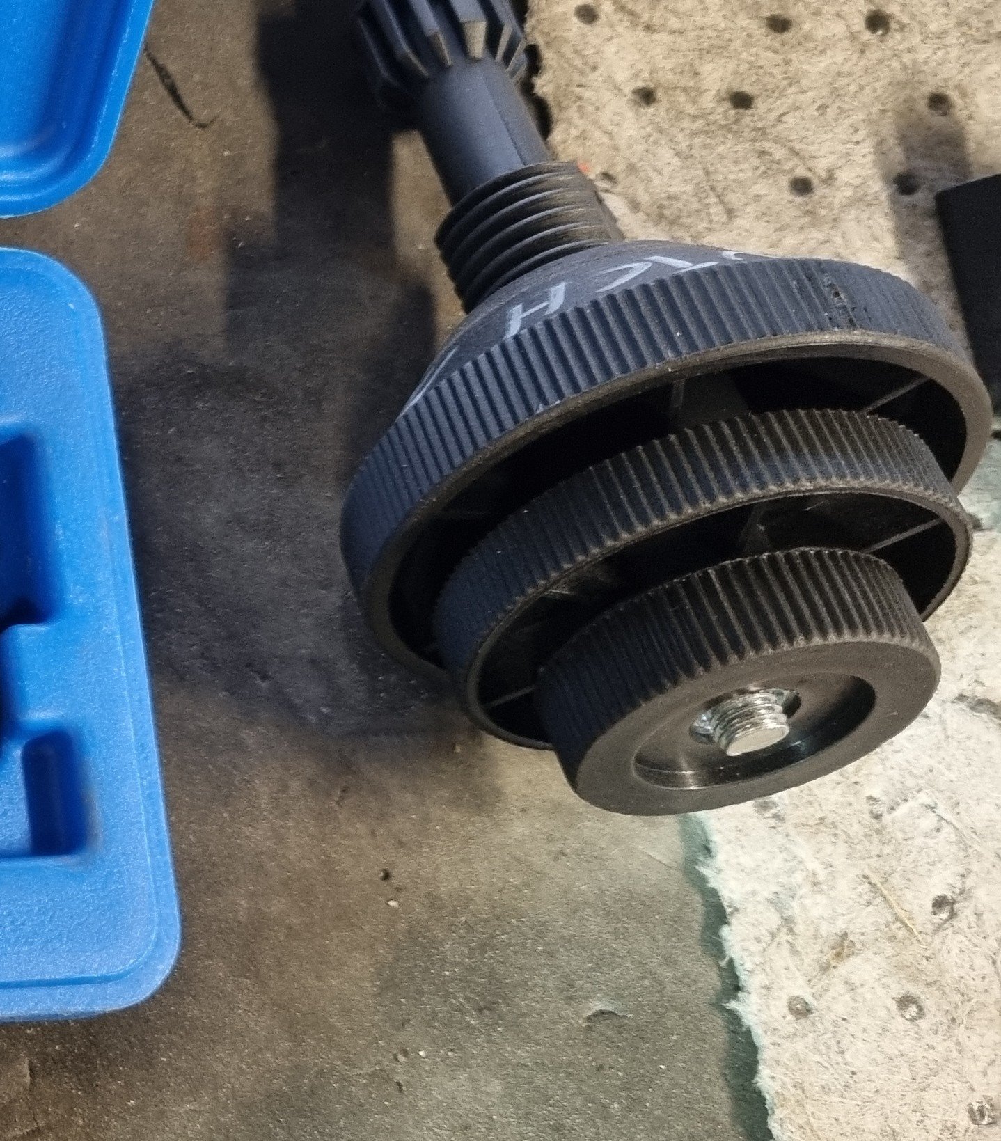

When doing manual clutch I do use this centralizing tool.

That is a similar or maybe the same centralising tool as I bought, even that is 800km away from me :sad: one day I will have everything in one place, its down to 2 places now but still one too many.

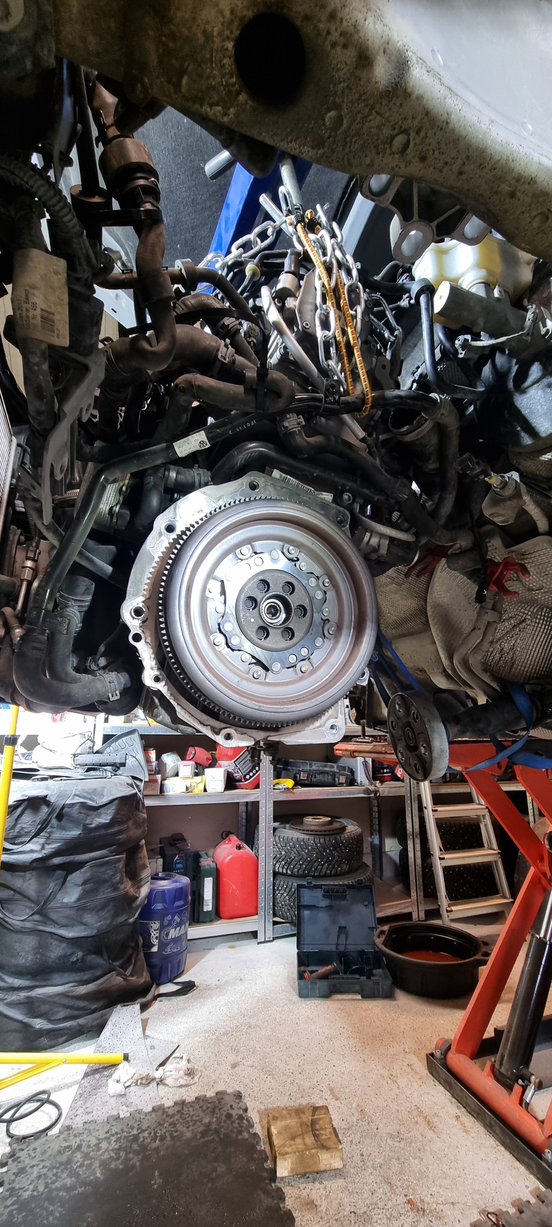

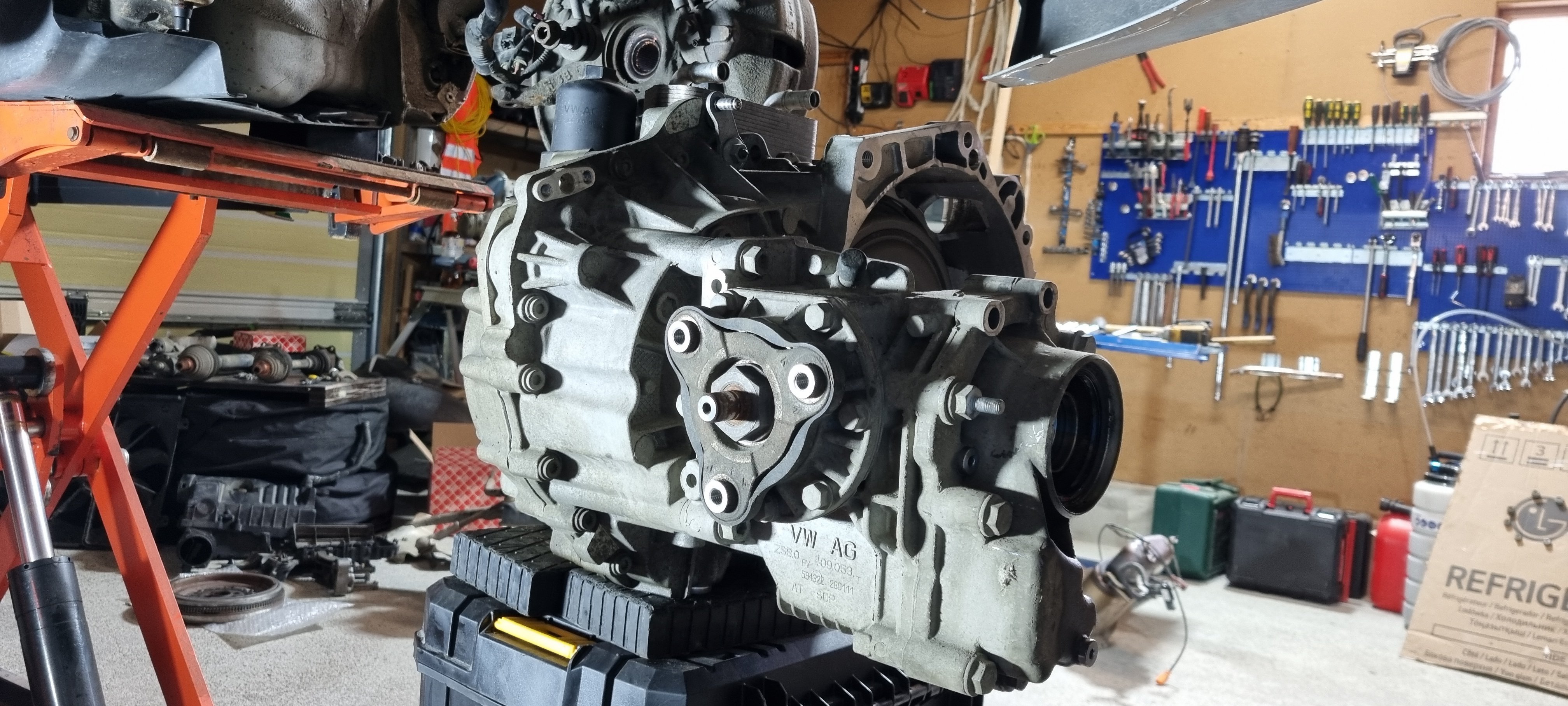

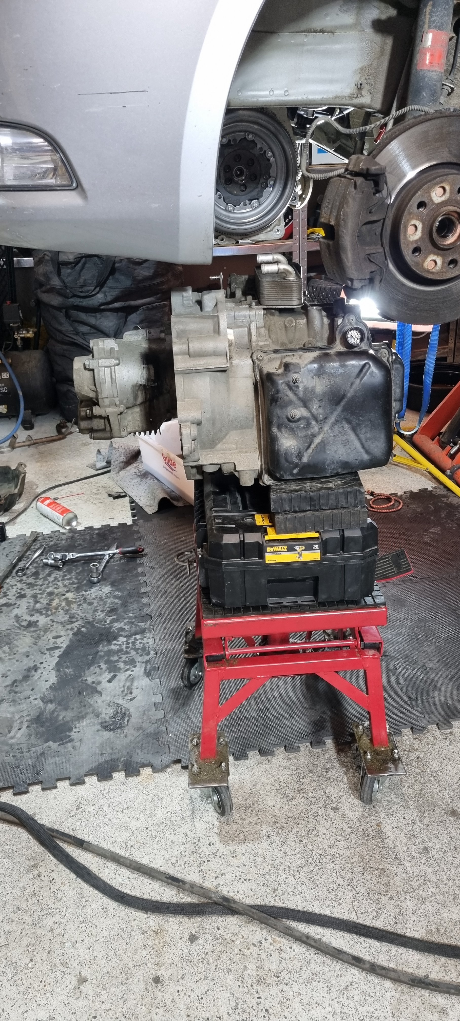

Dual mass flywheel done! Omg, what a ****ty job! Doing this on a dsg 6spd dq250 on a 4x4 drive car is not for the fainthearted I must say. Especially since the dsg box with the angle box is quite heavy. It is not necessary to split the angle box from the gearbox. They come down as a whole. Just remember to assemble it with the anglebox adapter in place before you connect gearbox back. If you forget....good luck (no need to remove the adapter anyway). In total I spent approx 13-14 hours effective. The egr cooler takes time, dsg oilservice takes time, coolant takes time and so on. It just add up to the total. Also, preparing tools finding them etc takes time 😄 So, next time I do this, I will estimate a weekends work aka no other plans for the weekend just to be sure. Some nuts will need cutting, som bolts need cutting etc. Well, please ask questions if someone need help. I have actually done it and now how labour intensive it is.
Some more pic
