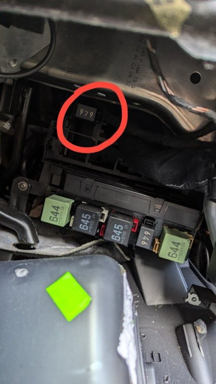

Thanks for that - I tried swapping in the other "646" relay but still not working, however even with the horn relay removed I could still hear a relay clicking when the horn was pressed? Not sure if I've got the wrong relay but everything I can find online points to that being the horn relay:
