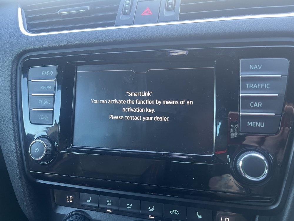

Ok i'll have a look again, I did see Smartlink but then it said something about contacting the dealer to activate
@PetrolDave I don’t see any Apple play or CarPlay just this? So I guess I need to get it activated first?
13 hours ago, Obsolete01 said:
@PetrolDave I guess I need to get it activated first?
Yep, it's not activated by default as it's a chargeable SwAP feature.
