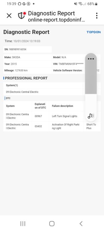

Not anymore. Hazard lights only flash on right hand side.  The bulb light on dash is on permanently on.
A friend of mine put a diagnostic of the electrics today, and it found this.
