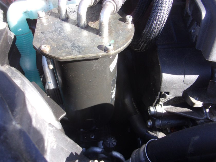

I started smelling diesel a few days ago but thought it was coming up the valley from the large building site below us. We've just enjoyed two solid days of rain bucketing down; I found lots of pretty colours under the front offside on the wet driveway so the smell was from our Yeti after all.
I'm unfamiliar with diesel cars although I have lots of experience with petrol cars; here's what I found; whomever replaced the filter at the last service hadn't tightened down four of the five screws shown in the picture; I'd guess one of the torx screws was lost and replaced by the very long pozi type type screw; only the pozi screw was fully tightened the other four possibly forgotten once the long screw was found and secured.
Can any member please identify this filter for me please; I've not seen one of these previously.

You don't say, have you tightened those 4 screws that were loose and still got a leak?
Hi,
Many thanks for asking Urrell. Yes I tightened the screws solving the leak. I've since ordered a dozen of these screws through eBay shortly to arrive; I'll replace all five and have a few spare.
I politely emailed the garage owner explaining what I'd found and he replied with an apology admitting his mistake saying there's no excuse; he carried out the service and has been honest about it..

I posted asking what this filter was in order to check it was indeed a diesel filter because I'm used to petrol engines having an oil filter this size; I didn't understand the three pipes in its top but obviously now I'm more experienced. I'm sure the new screws will be OK but I'll update once they arrive.
