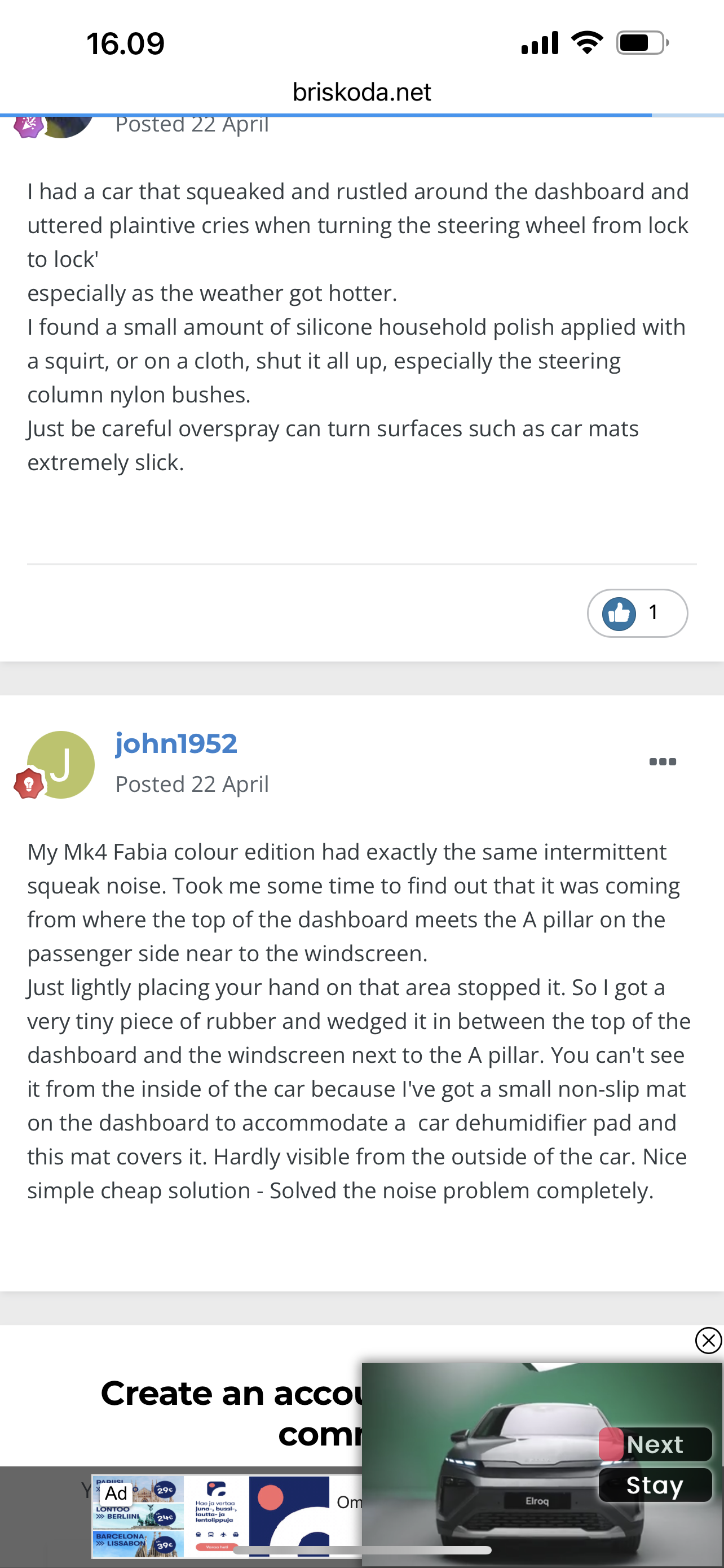

Hi! Greetings from Finland. I have the same frustrating noise in my 2022 Fabia. Have not been able to locate it but it seems to come from the passanger side dashboard, maybe. It comes very often, also in low speed and good asphalt, and more often when it gets colder.
Just found the below discussion. Might this be the reason? Please let me know if you find the solution.
