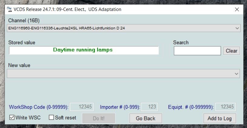

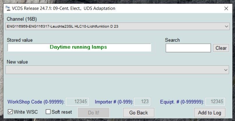

Tried this this morning. In the latest version of VCDS, there are two options "Daytime Runnings Lights", tried this and it didn't work. Next tried "Daytime Running Lamps", success.
Have attached screen shots of this.
Also thanks for the link, have enabled a few further options, Fuel refuel quantity, cornering fog lights and automatic daylight saving time update.
