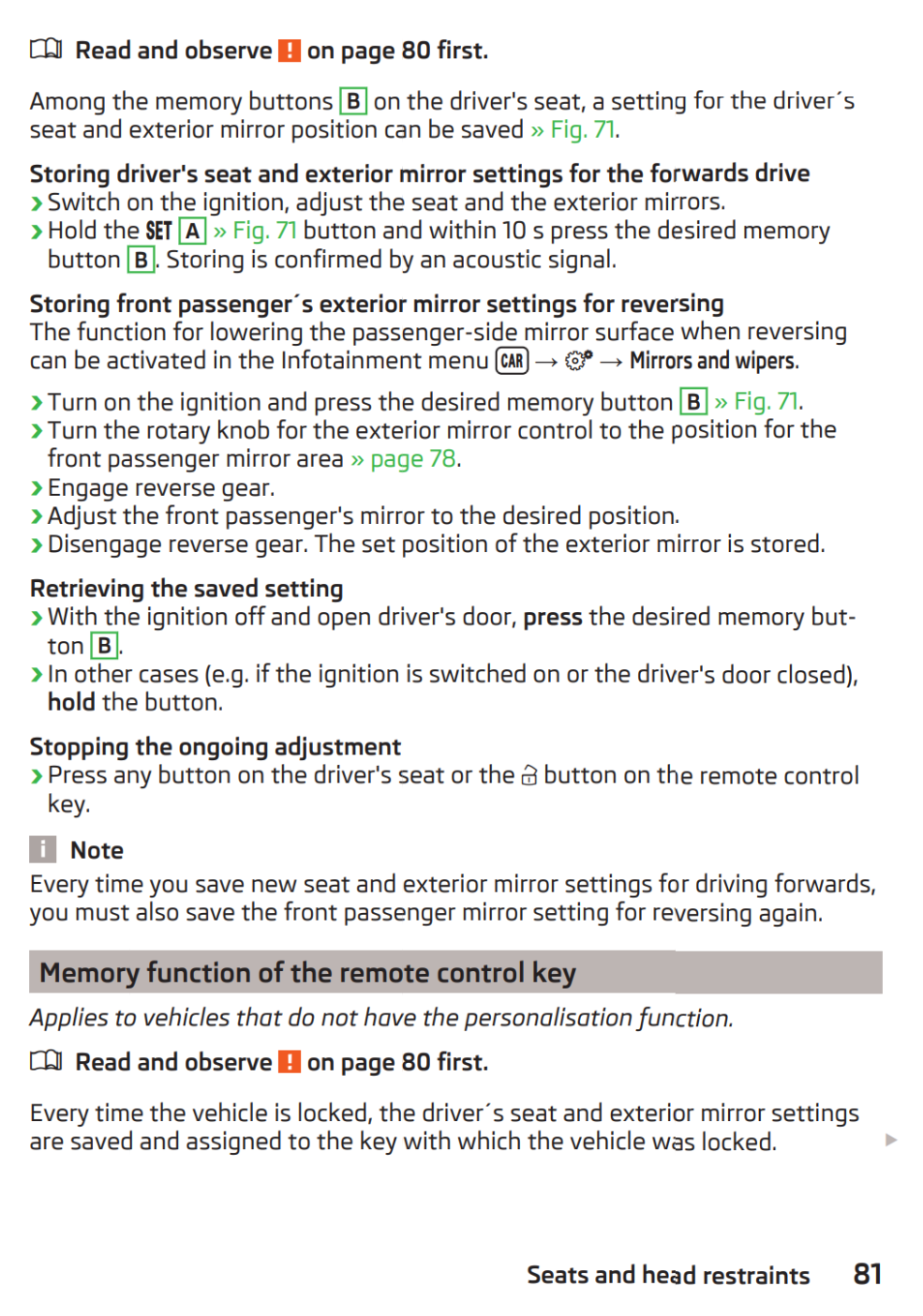

@Trinity99 - u could try running through the reverse mirror dip learning process again, as per the user manual, to see if that fixes the issue.
other things that come to mind is potentially a faulty seat controller module (#36).  there has been a TPI issued for it, that updates the software/firmware from version B H08 0021 to version C H09 0024.

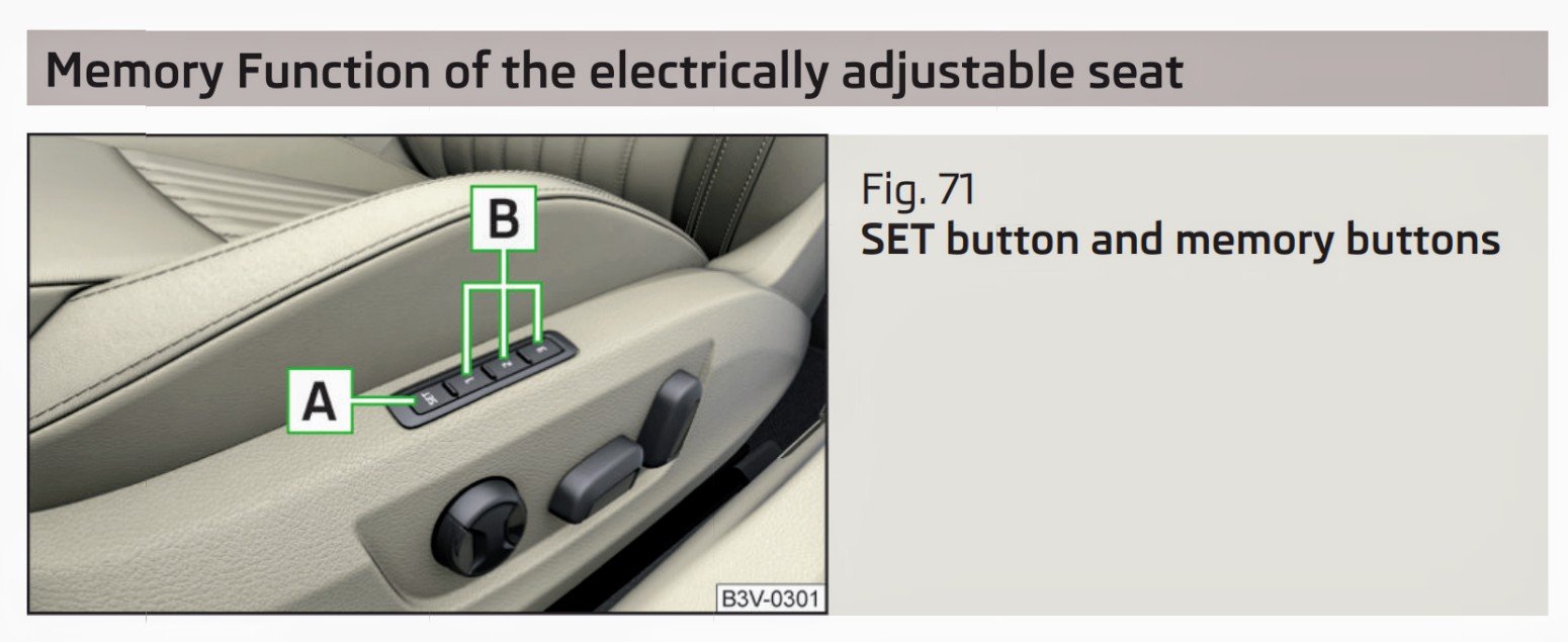

Hi JR, I've changed the battery dip worked fine for some time, but the problem came back.
Could you point me to the direction where I could find the learning process you mentioned? Can't seem to find it.
@Trinity99 - saw ur message.
I missed this earlier.
Below is from the user manual.
Ffs no idea how I did not find this.
Thanks so much gonna try tomorrow!
