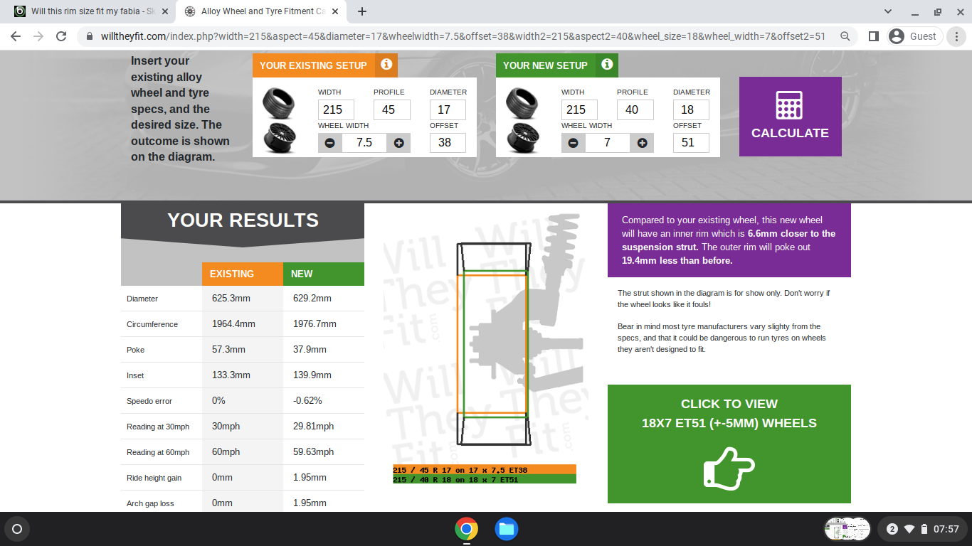

i am looking to buy winter set of rim/tyres for my 2023 fabia monte carlo 1.0tsi 110hp,
i have an eye on 17x7.5 et38 rims. Presently i have 18x7 et51 libra rims with 215/40/r18 tyres
what do you thonk 7.5/et38 would make significant difference?
