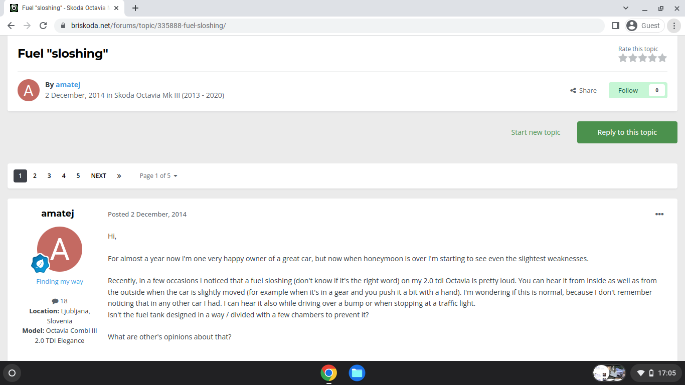

Hi,does anybody else have a problem with hearing their fuel tank sloshing about when braking ?
IIRC this was mentioned on here a few years ago as happening when the tank is about 3/4 full due to there not being any/enough baffles in the tank.
