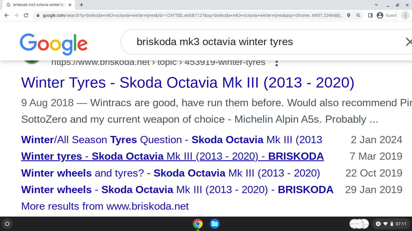

Welcome to the forum.
Always worth having a look at the various threads & posts on the same subject.  Most subjects have been covered many times.
Wheel & Tyre section and this section.
Briskoda search or Search engine key words.
