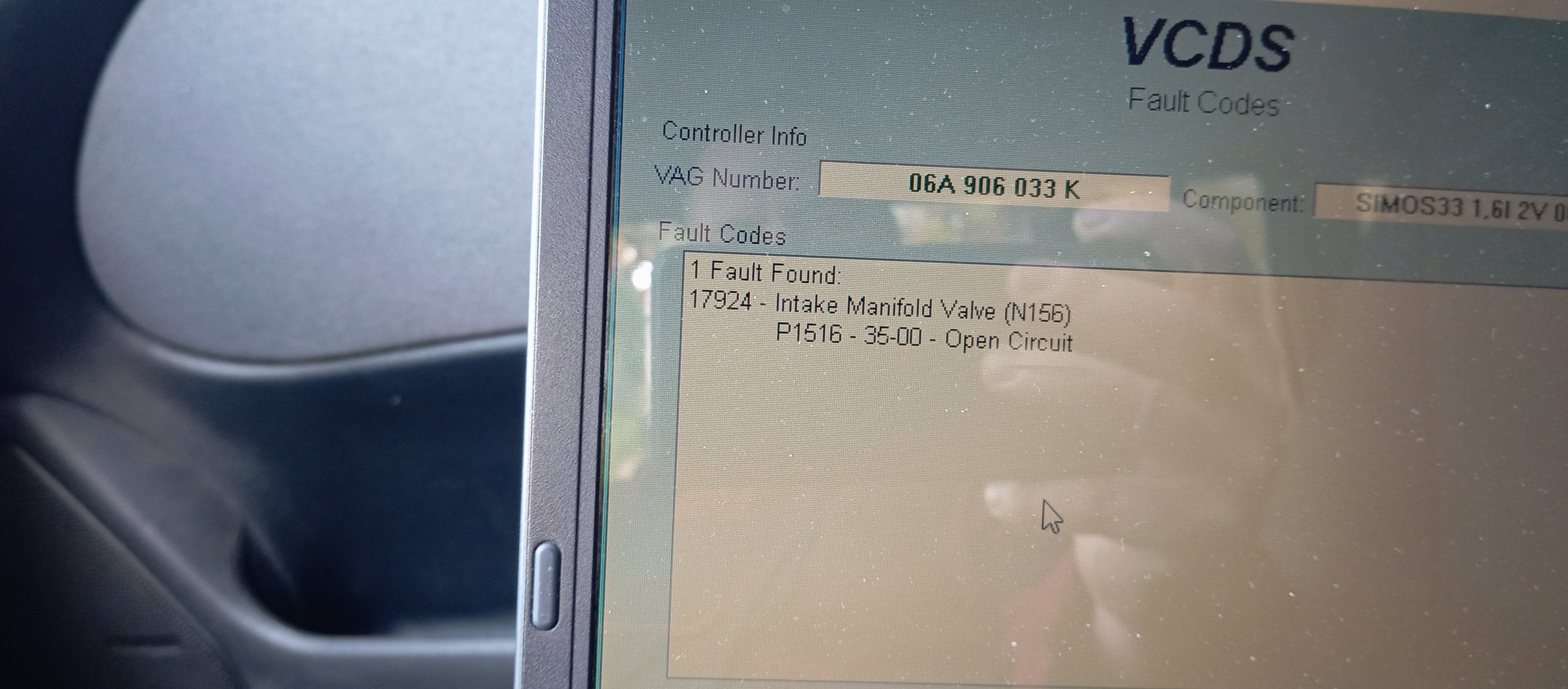

Skoda Octavia Mk1, 1.6, petrol, engine code AVU, BFQ. After the water reaches 90, the ASR warning light appears on the board and the following error:
17924 - Intake Manifold Valve (N156)
P1516 35-00 Open Circuit.
I changed the two vacuum pumps - 1J0 906 283 C and 037 906 283 C. Likewise, no result. I checked the wires. Everything ok Where else could I check? Thank you.
The ASR button is useless, it cannot be activated or deactivated. If I clear the error, the ASR button works.
The error appears when I drive around town, with frequent braking and starting. If I go a long way, it doesn't appear. When I get home from a long drive and turn back to park the car in the yard, it appears
Can someone tell me where this valve (intake manifold valve) N156 is on this car model?
