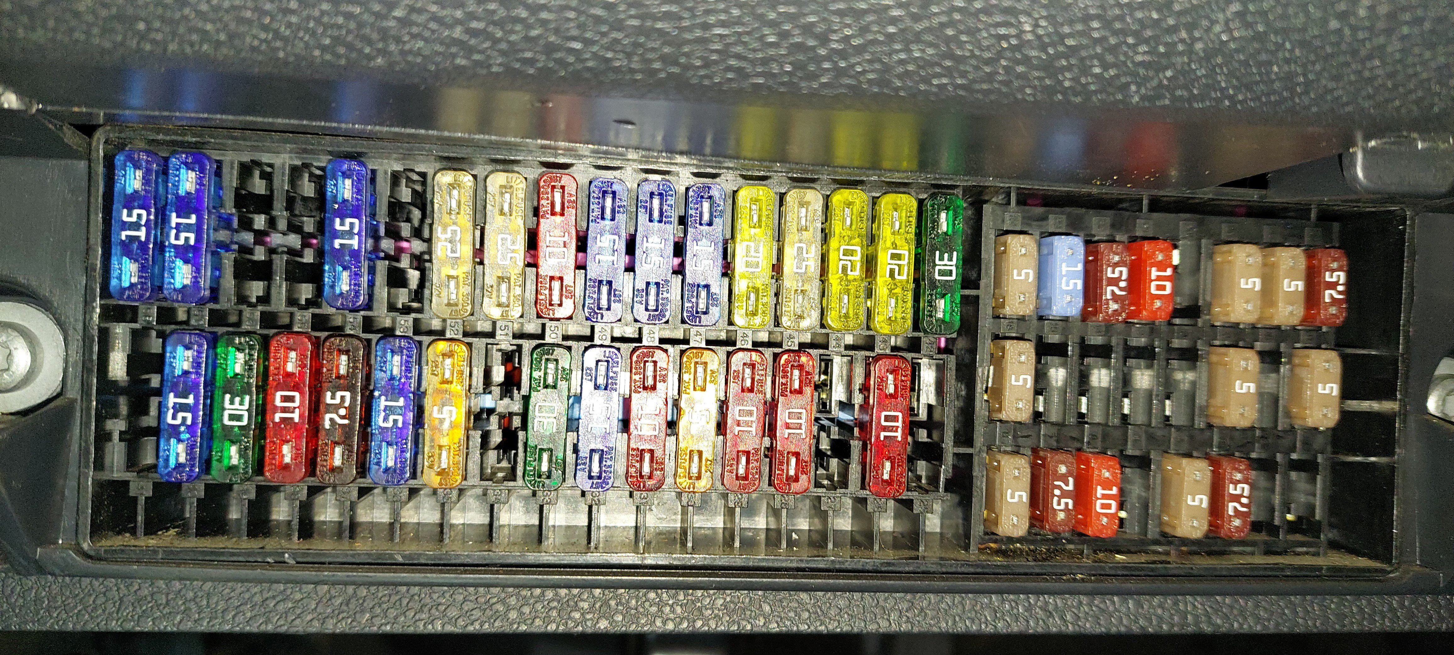

Hey Jocko, thanks for the info, your fusebox is slightly different to mine as its a petrol from 2009, according to the Haynes manual Section 12 page 46 you have a fusebox that was installed upto Feb 2010, like mine the fusebox is the same body as the LHD version merely rotated 180 degrees clockwise so fuse 1 is bottom rh micro fuse and fuse 24 is topleft of the micro fuse rows. Like mine you seem to have empty slots and the slots themselves are missing the metal jaws inside the plastic holder implying that when the car was build these fuse slots were never required to be filled.
As you see from my attached 1.6 tdi fabia elegance built aug 2011 I also have slots missing the metal jaws and I am going to suggest there should not be fuses in these slots. According to my haynes however as my car was built in aug 2011 there should be a fuse for the radio in fuse 1 for the radio, as you can see I dont have this. Also haynes says i have a fuse in slot 2 for the Starter relay OR not used on other websites it says this is the "start-stop" fuse whatever thats supposed to mean. Fuse 6 is supposed to be the Reversing lights cornering lights or Reversing lights according to Haynes, as I dont have this fuse in place im going to suggest my reversing lights go through fuse 21 (which I do have) and according to the Haynes is also for Reversing lights Or Reversing lights Cornering lights.
Frankly the variety of changes in the fabia fuse layout and options as to which fuse does what is a mess in my view and I have worked with enough engineers to know how it should be done, the end user has not really been considered.
Now that I have established I cant trust the haynes to tell me exactly which fuse holes should have fuses in, given that my radio works and fuse 1 is empty ! I am assuming the radio is coming through fuse 17 (which i have) or fuse 50 (which i have). So im going to run through some tests and see what happens.

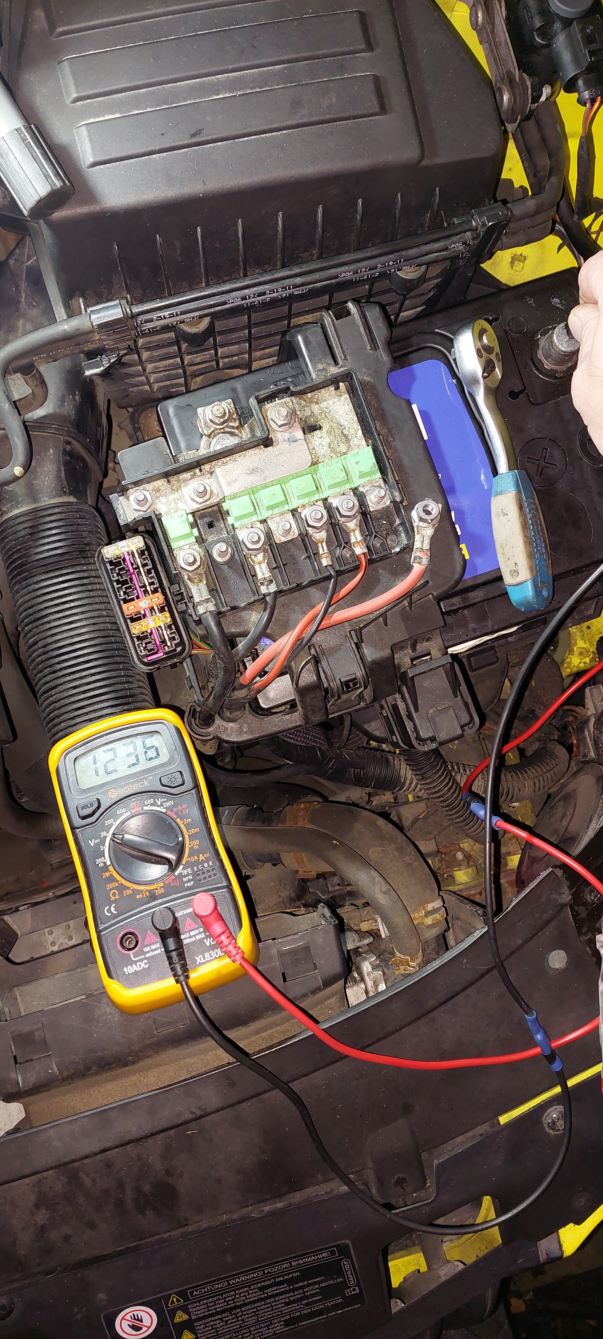

So back to the battery and undo the negative lead from the battery terminal again and measure the current drain in mA.... NOTHING !!!! (well 0.002) I cant believe it......Hold on though now lets not go mental i think. I turned the dial to test for the voltage between the negative terminal and the negative lead and its still  12.8v flowing back into the battery. So i turn the dial back to test for current flow to double check and I seem to be getting 0.016 mA on the 20mA range of my meter.
Ive left the car alone for a bit , with the negative lead attached. Im going back out to check it now to see what the current draw is now.

Ive just been out and measured things again.
So, measured voltage between the neg terminal and the neg battery lead and it was 12.28 v
Also measure the amps between the neg terminal and the neg lead, started on the 200mA and got no reading, 20mA got 001 reading, range set on 2mA got 0.01 then set the range on what i think is 200micro amps and got nothing. The attached picture is an image of the ranges on my multimeter the range in red is the one i am thinking is micro amps but I can be sure.
The reading in the 2mA range of 0.01, is that .01 of a milliamp then ?

To measure voltages you don't disconnect leads. Leave everything connected up and measure the voltage across the battery terminals. A good battery should be 12.6v. Your reading of 12.3 volts suggests to me the battery is not great. 0.01 on the 2mA range on your meter is just noise.
If you have a simple circuit of a 12v battery, a switch and a lamp all connected in series (wire from battery + to switch, switch to one side of the lamp, the other side of the lamp to the battery - ) then you will measure 12v across the battery and everywhere up to the switch. Close the switch and you will get 12 volts everywhere up to the lamp. This will still be the case even if you remove the bulb. To measure current you have to break the circuit and put the meter into the circuit. If you did you would not get current flow when you opened the switch or removed the bulb. You do get meters that clamp around a cable and measure the current flow but these are usually for large currents and impractical for measuring small current flows.

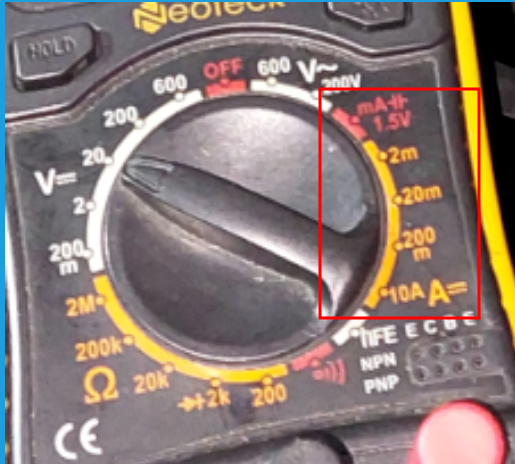

Ive now found something on the internet identifying this mystery range as “1.5V mA” setting on a meter is used to measure the current at a 1.5V voltage level, typically for testing how much current a circuit or device draws at this voltage"
I cant understand why this worked on my 12v battery however
I found that on the internet. It is another function on some multimeters. Nothing to do with the 2mA range on your meter. The range is actually mA @ 1.5v.
