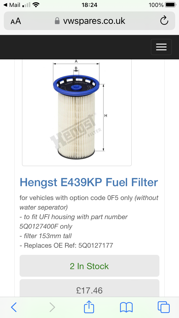

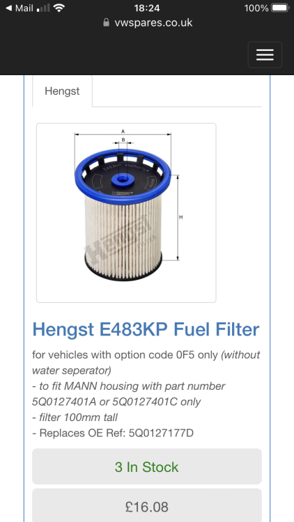

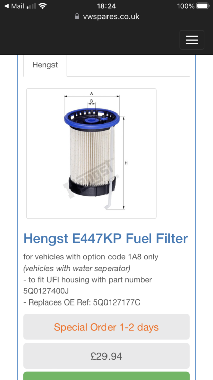

Regarding to the Hengst fuel filter I recieved the E483KP through my workplace as I can purchase cheaper and its slightly shorter than the previous Mann PU 8028 filter (Like 4cm)
Do you guys think is it going to be a problem or am I safe, AUTODOC says it fits my Superb 3v5 150 PS 2018
