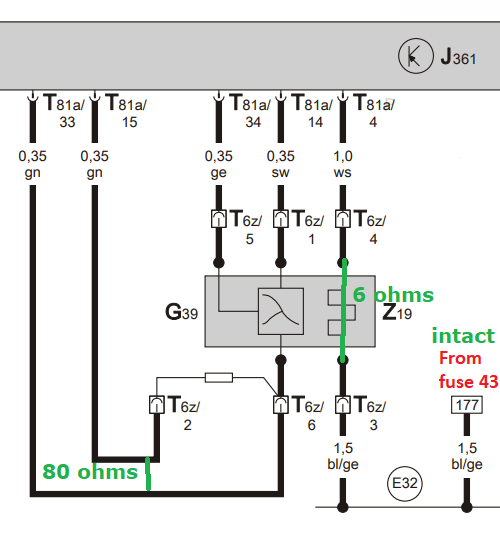

  • Lambda heater wire resistance 6 ohms
  • Lambda connector harness pins 2 and 6 80 ohms
  • Fuse 43 intact

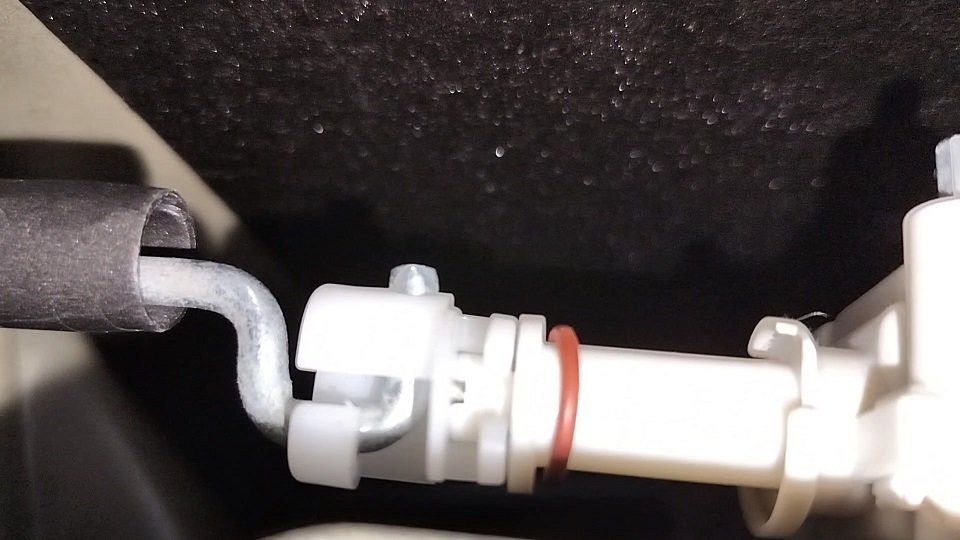

    • See image 1

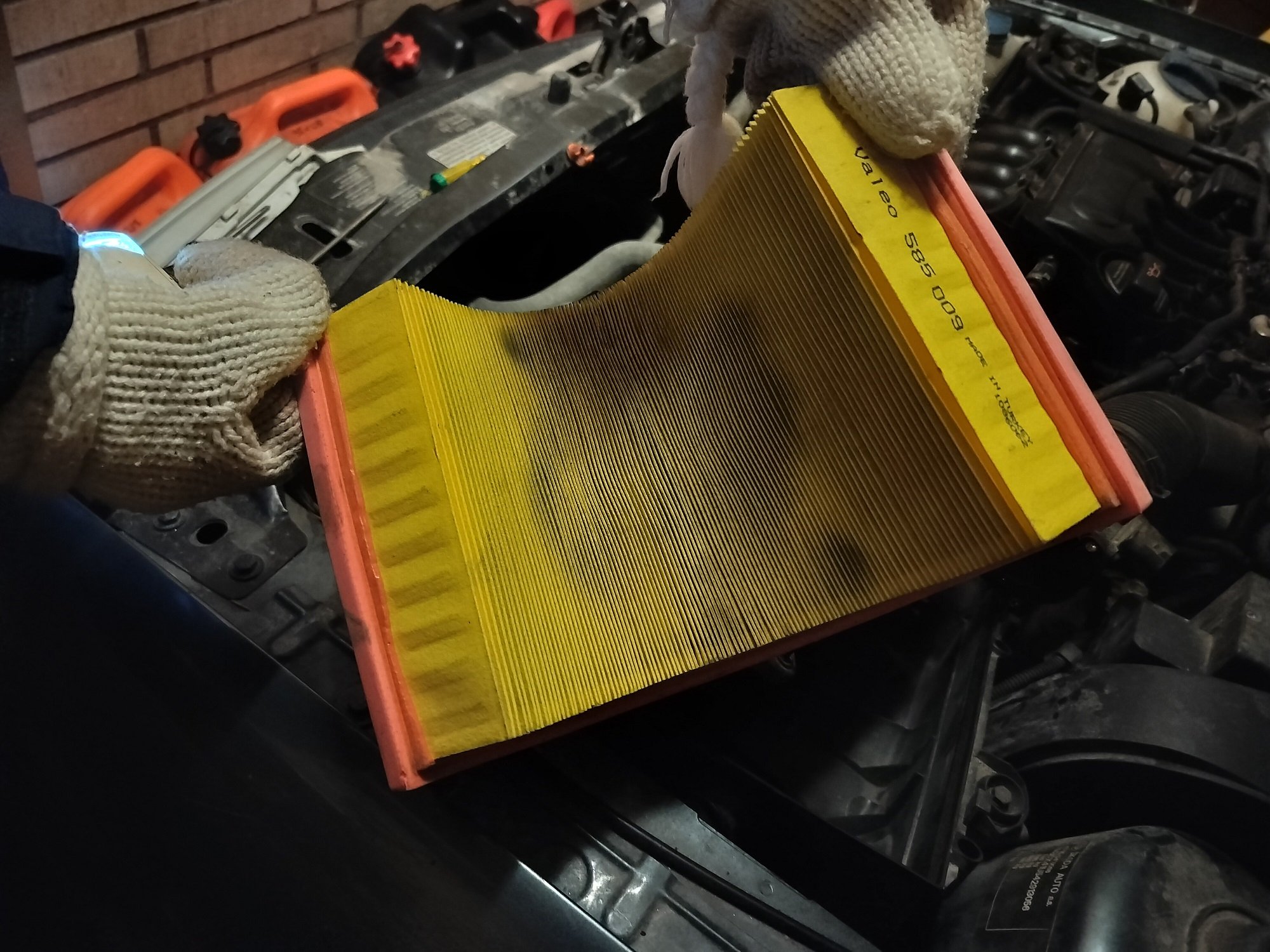

  • Air filter fairly OK?

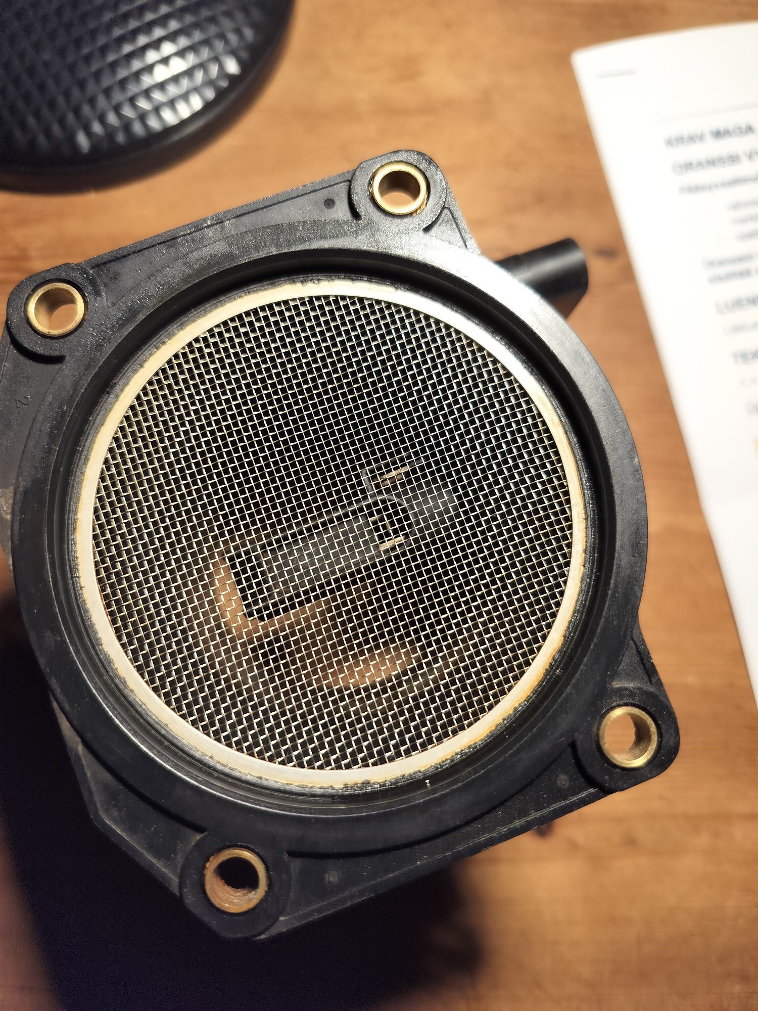

    • See image 2

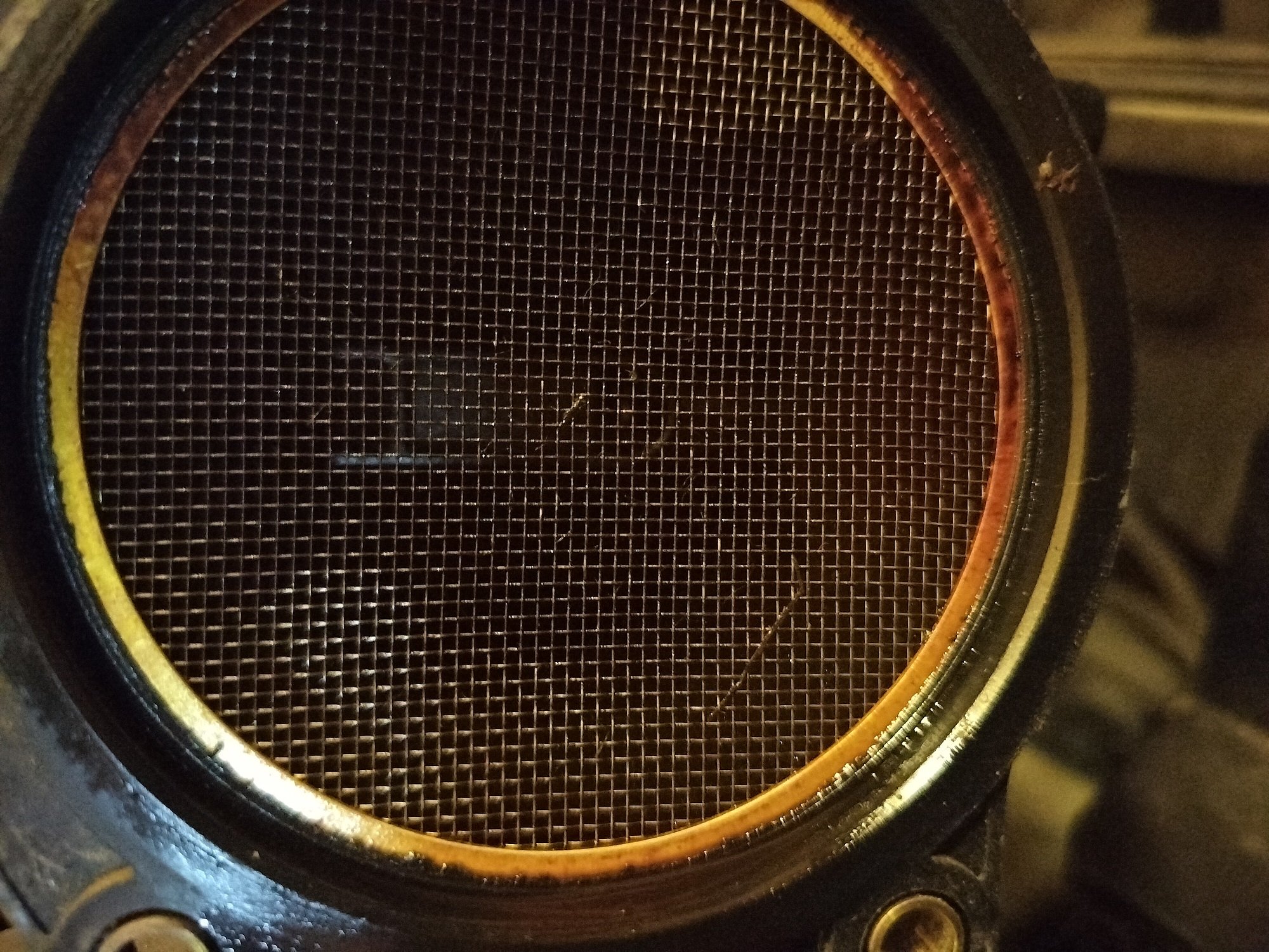

  • MAF was pretty oily (cleaned now)

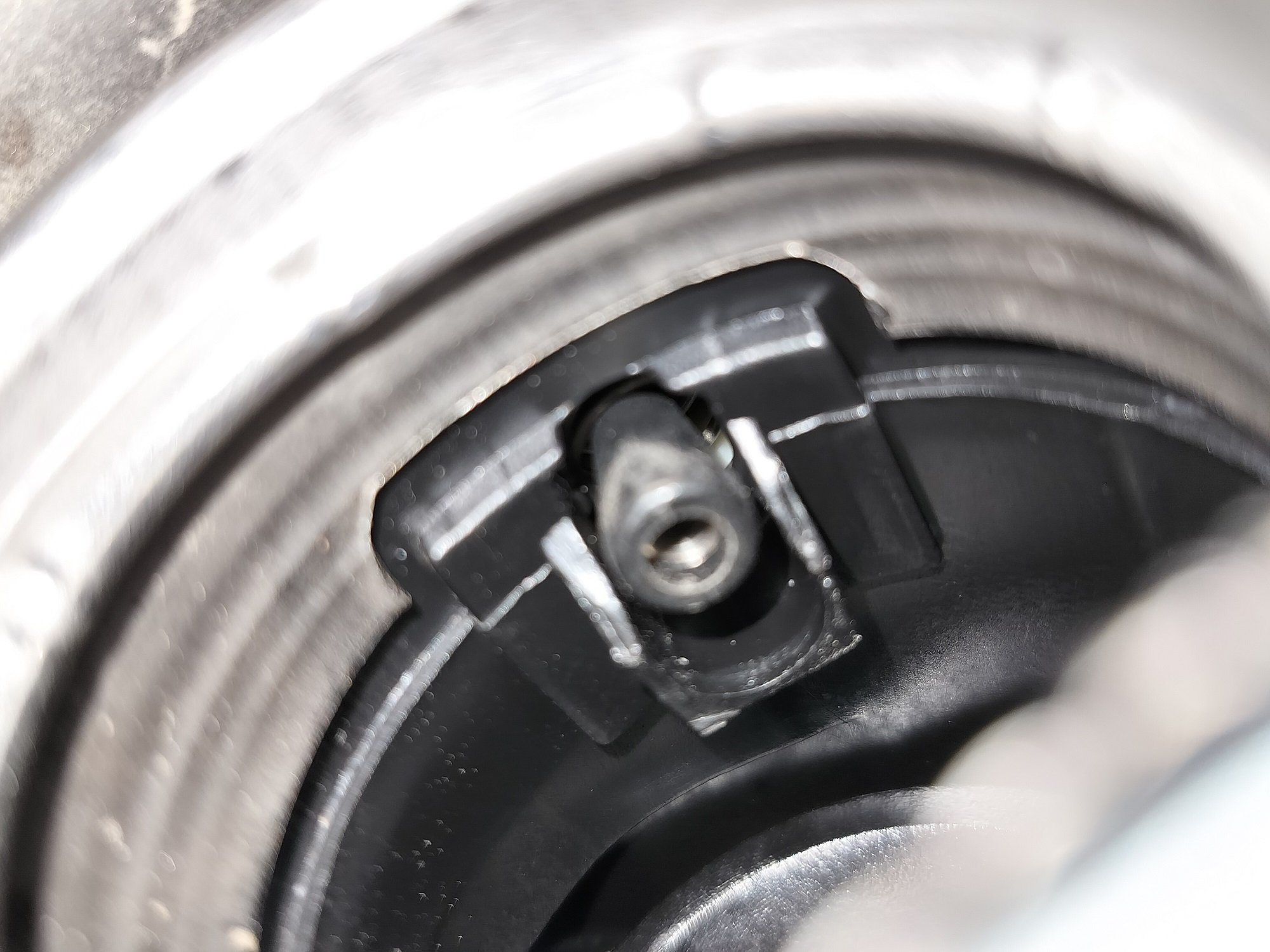

    • See image 3 and 4
  • Tank cap sensor
    • Sensor disconnected
      • Power wire to ground 12.6V
      • Signal wire to ground 0V
    • Sensor connected
      • Power wire to ground 11.8V
      • Signal wire to ground 11.8V
    • Does somebody know how this sensor is supposed to work and how to properly diagnose? I assume this is related to EVAP?

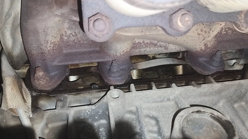

    • See image 5 and 6

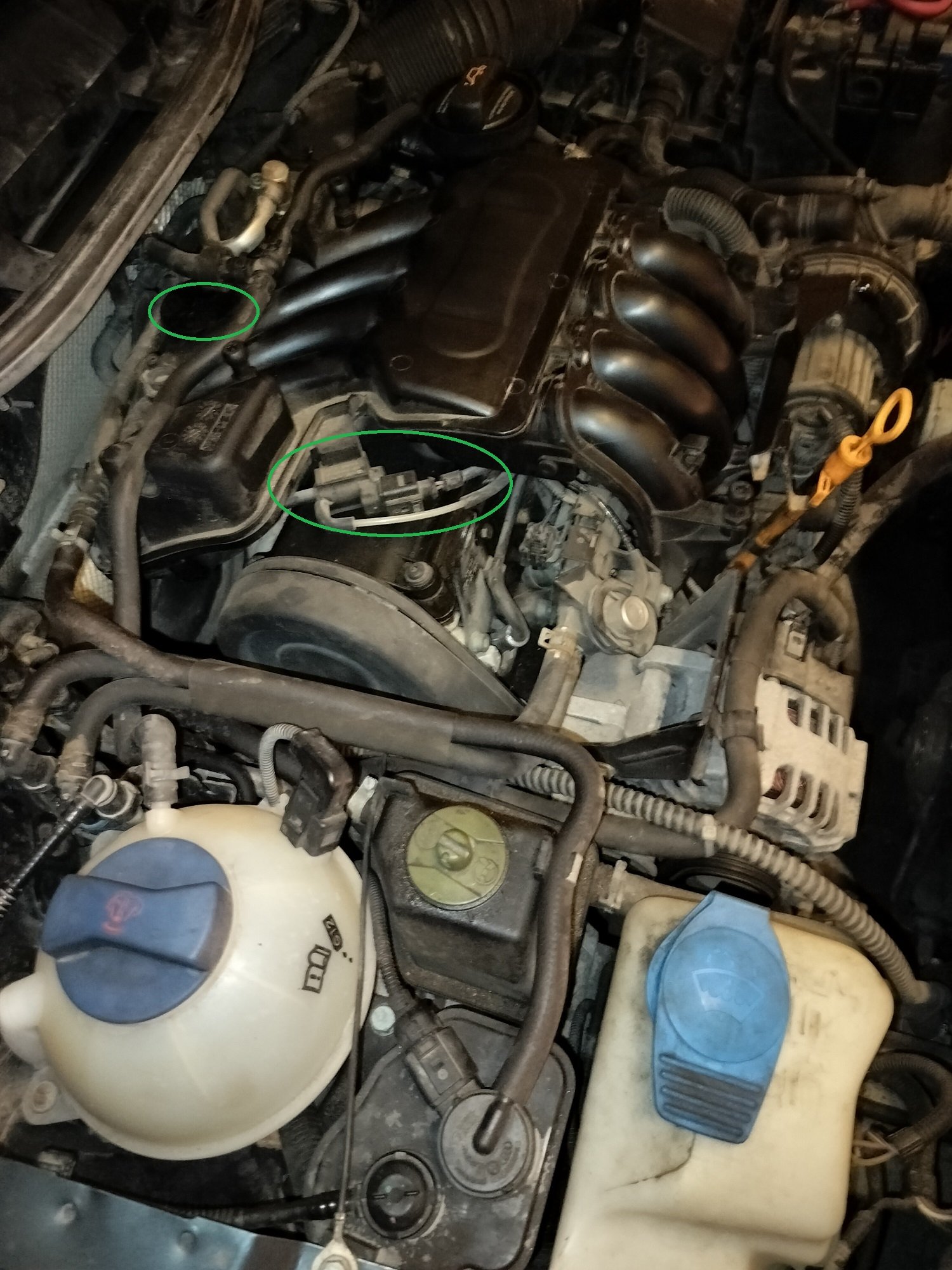

  • Hissing sound coming from somewhere at the intake manifold. I think related to the solenoid valve as the hissing is most prominent at the places related to this. Does somebody know how this supposed to work? I could only observe the hissing at idling bcs i was alone diagnosing.

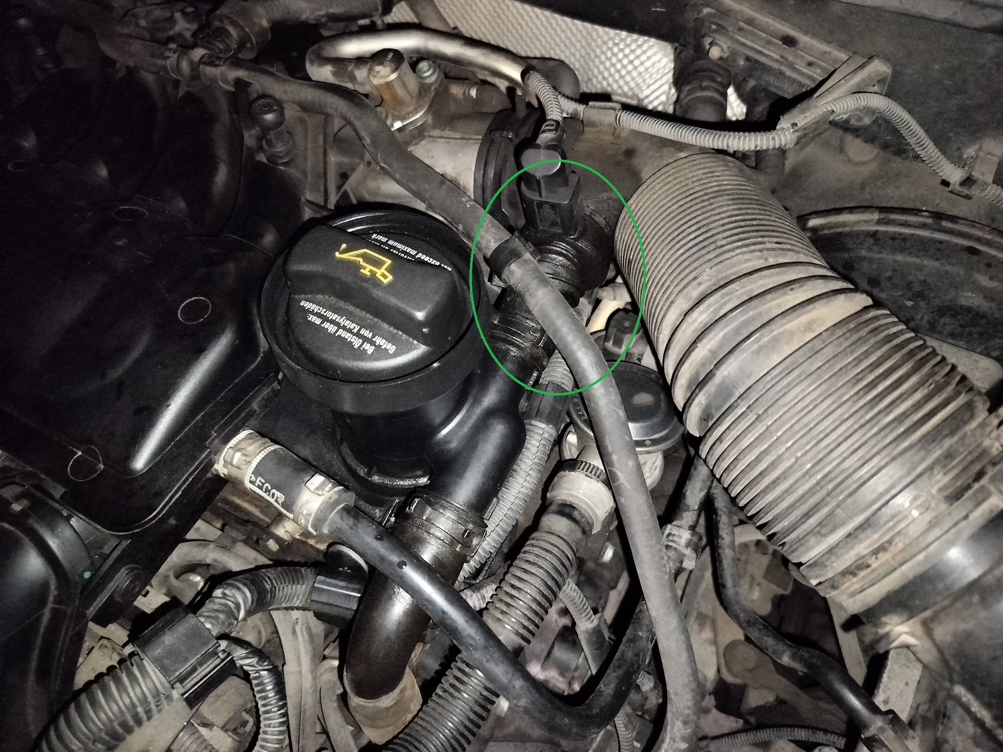

  • Oil was spread at the connection pipe between oil filler and intake pipe (is this the crankshaft ventilation valve?).

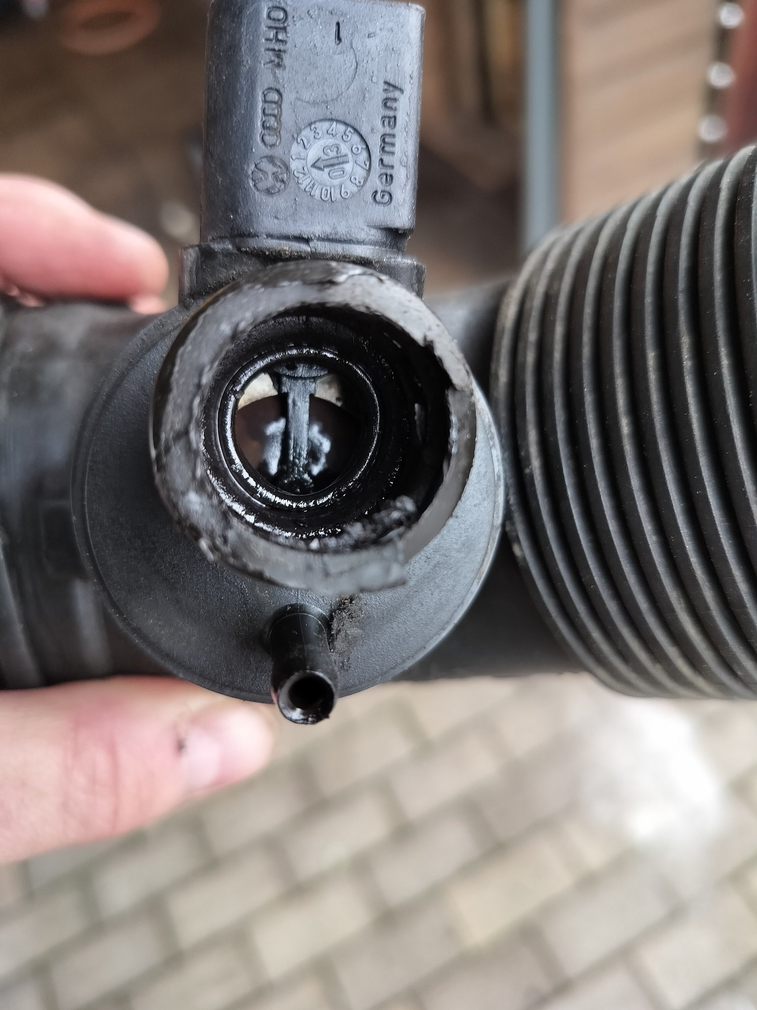

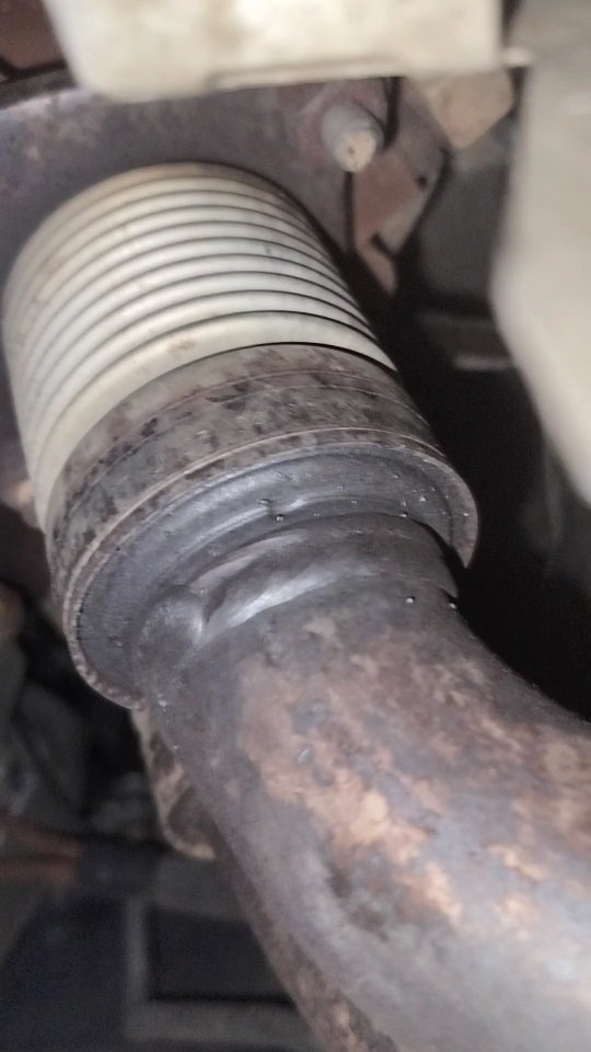

    • I disconnected the intake pipe to clean this part but at this stage this smaller connector pipe broke into pieces. I suspect it was already leaking/broken before i touched it hence the oil all over that specific spot.
    • Inside the intake pipe there is some valve or membrane which was also very dirty. I cleaned it with break cleaner (not sure if it was a good idea). This part has also two electric wires attached. Is this a sensor or a valve? What is the function of this? How to test it? For now i put the cleaned intake pipe back and fixed the broken pipe part with piece of hose.
    • See image 8 and 9

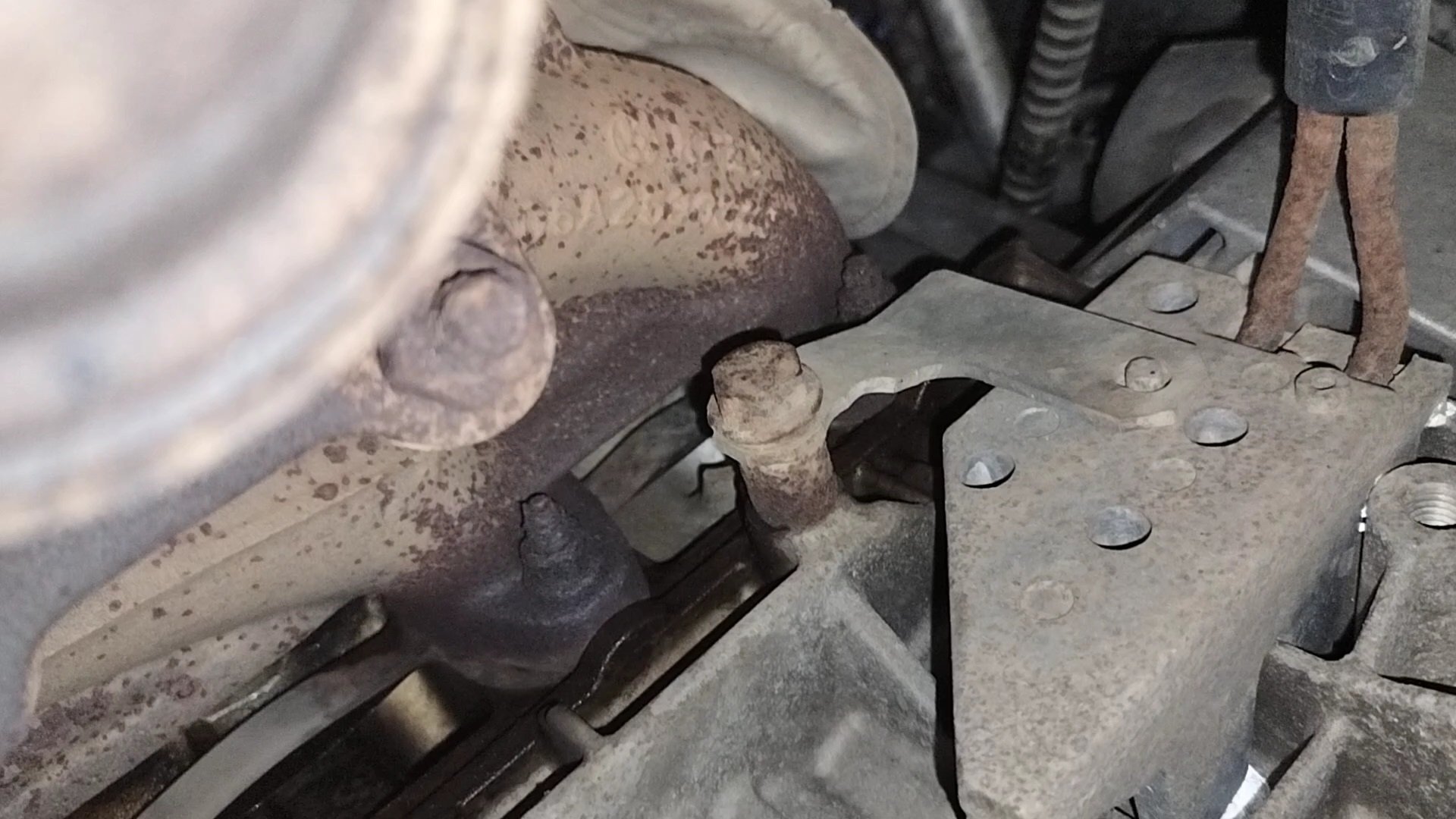

  • Exhaust manifold seem intact in my opinion but also there traces of oil was visible at the manifold.
    • See image 10, 11 and 12.

I would start by addressing the hissing sound as a priority. Any air leak after the MAF can cause idle fluctuations and alarms, so make sure all is well in that area.
A. Replace the broken connection between oil intake plastic adapter and air admission pipe or, at least, be pretty sure there are no leaks there in order to proceed.
B. Check the air admission pipe integrity, the one coming out of the MAF. Also make sure the breather valve (membrane) inside is in good condition. Depending on your mileage, I would also replace this pipe, especially after reading the MAF was oily, as the breather might not be working properly.
C. Check/replace the thinner air connection pipe  going from the small exit  (shown in pic 8) in the air admission pipe to the rocker cover area.
D. Check for leaks in vacuum pipes. I replaced all of mine as a preventive measure.

The solenoid valve you mention, next to the intake manifold, applies vacuum to flaps inside the intake manifold, making them turn in order to allow more or less air into the combustion chambers.

Concerning the electrical connector in the air intake pipe, check here:

As for the oil consumption/leaks, have you checked the following? You probably have, just making sure.
A. Air breather in air intake pipe working properly.
B. Rocker cover gasket leaks.
C. Oil intake plastic adapter (on top of rocker cover) leaks; check integrity as it can crack, and also top and bottom seals.
D. Oil residue in coolant.
E. Oil pan leaks.
I took care of A. and C. and oil consumption in mine was reduced by a large amount.

Regarding the air intake pipe, for now it is fixed with a piece of hose. As tight as possible and sealed. The membrane in the pipe is possibly gone bad, not sure how to check its integrity but i was planning to buy a new air intake pipe. If the device attached to the connector pipe is indeed just a heater then i might go with the cheaper type without heater untill the issue is resolved. Tough i live up north so this might need to wait till better times...

I don't think the solenoid valve should be a concern at this point, at least from what you described; a bad solenoid would entail poor response when driving.

2. However, oily pipes do tend to degrade, as you have noticed, and may allow unwanted air into the air admission circuit.
3. Despite the replacement of the shattered adapter, the breather in the air admission pipe might not be working properly, thus the oily MAF; in that respect, have you cleaned the MAF's filament as well?

6. Numbers 2. and 3. might be related. The engine light probably came up due to the lambda sensor problem. You appear to have another problem with the lambda sensor, thus the engine light again.
7. However it might not be as straight as it seems. Check this thread:
8. Lambda sensors testing procedures:
lambda.pdf
