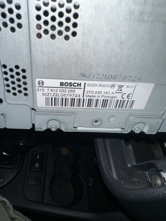

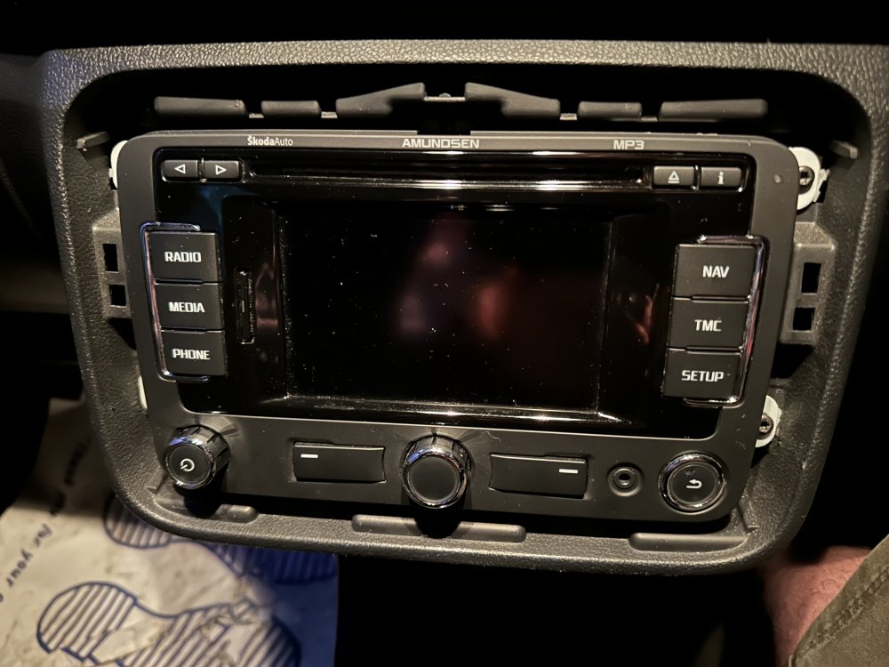

I unfortunately made an assumption about the Audio/Navigation that it had Bluetooth. It has an RNS 310 AMUNDSEN head unit with a PHONE button and phone symbol on the steering wheel controls which I assumed meant it had Bluetooth.
It has taken me a couple of hours of Googling and reading to find it doesn't ..... the phone button just mutes the Headhunt and there is nothing in the MFD menus
