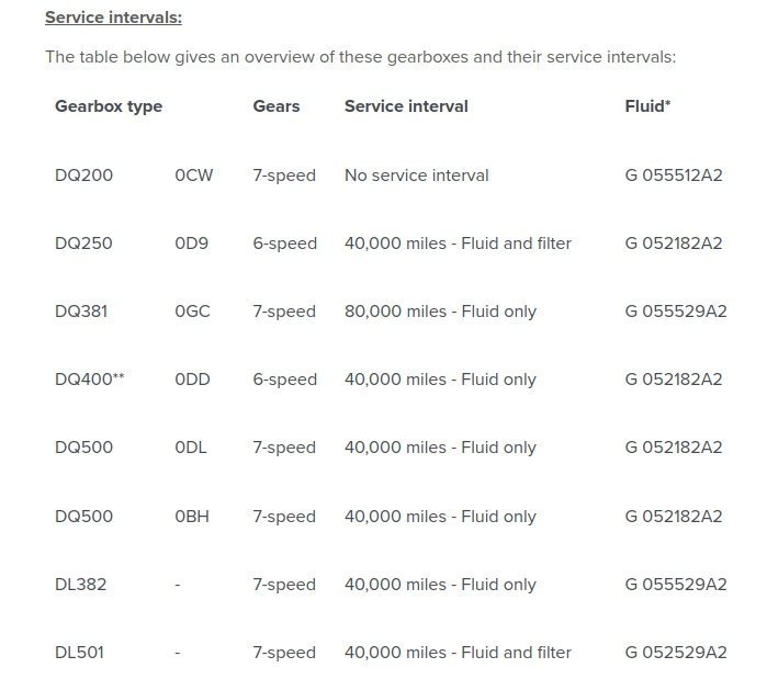

So, my Indie (and the dealer) are both saying the DSG is fine until 80k miles. Almost everywhere else Indie wise says to do it around 40k… I do trust this place - their bread and butter is tuned RS6’s - but I am a bit surprised they said 80k too.
Any thoughts?

DSG, yes, agree - get that filter and fluid changed.  Depending on who you go to (I would recommend independant VAG specialists these days, Skoda dealers are terrible) - you would be looking at £300 for that service.  I agree that 80k is excessive.  I've seen the VAG ATF fluid beginning to breakdown at 45k miles, so this is a good call.  Its the mechatronics that cause problems and are the expensive parts (although not so much on the DQ381 boxes)
