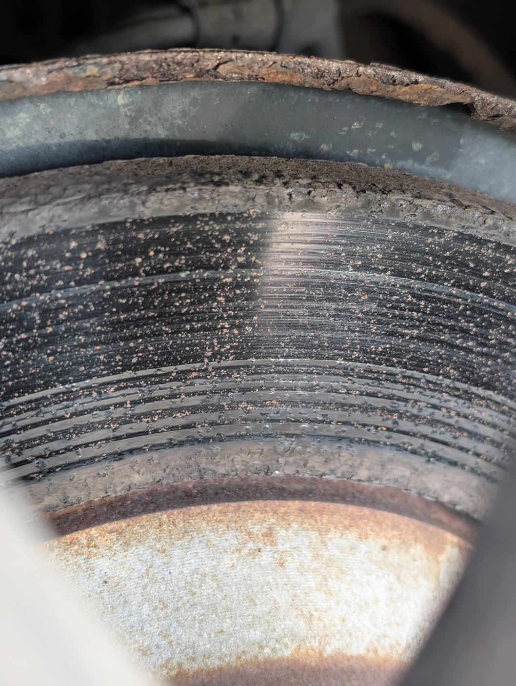

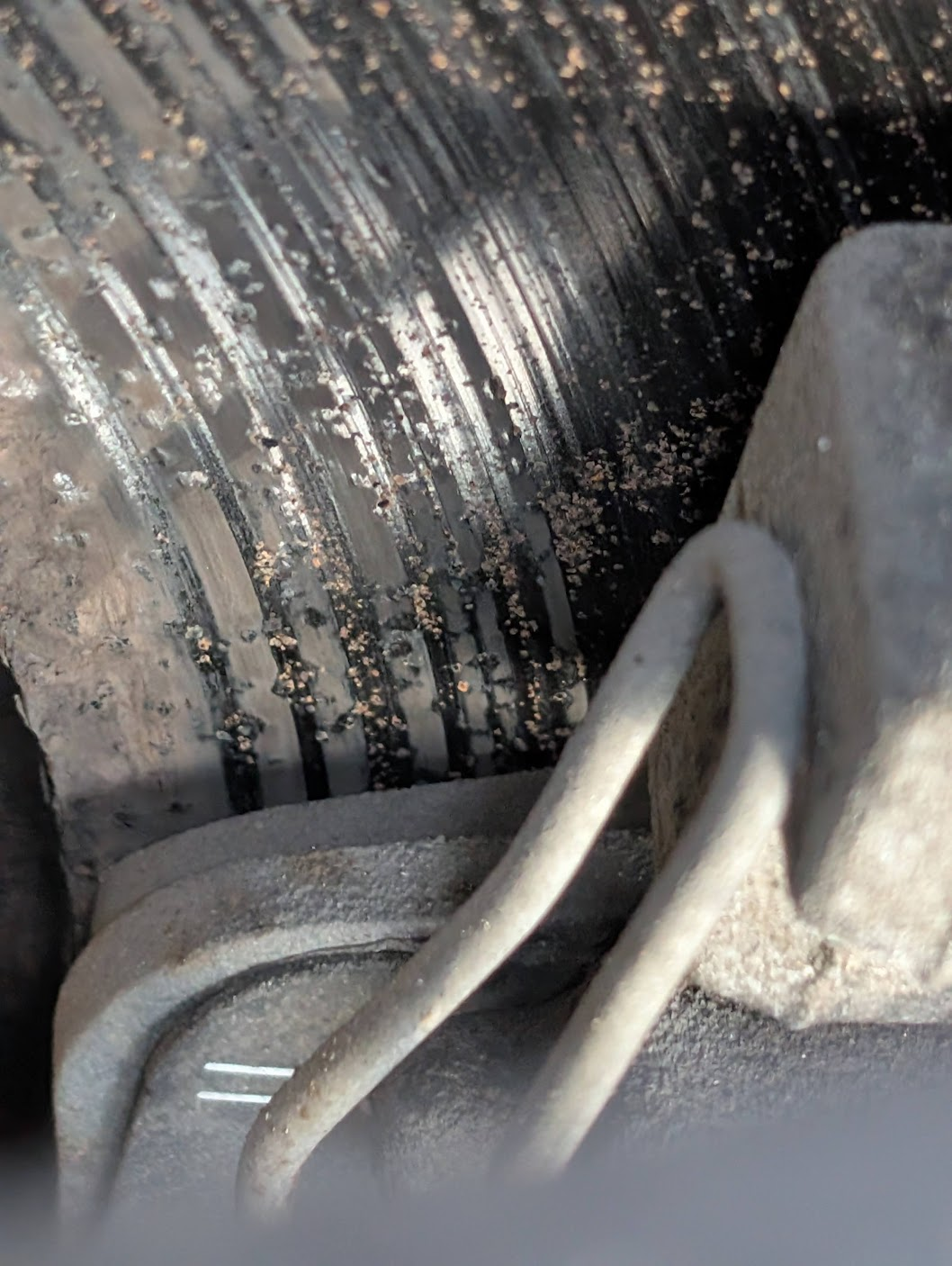

the driver's side rear brake looks like this. The brake pad on this side doesn't seem to be making full contact with the disc, the disc shield is also fairly corroded for a 2020 car. Is there a common issue with this or do you know why it may be happening?
The car has only done 14k miles, but since I've had it 3 months I've covered 3k enthusiastic miles, with plenty of braking, including heavy to test them out. They do feel less effective than my octavia and are at least 100% worse than my wife's mk 7.5 golf.
I'm under the approved used warranty - would this cover anything
thanks
It’s very common; however your passenger side should look similar, if it doesn’t then that’s not common at all and could be a number of things.
The brake dust shield going crappy is common too but a much bigger job than it needs to be in replacing the rears, it’s on my to do list of using something like kororust and some hammerite black paint to go round the edges (done the same on my wife’s fiat 500 rear drums and held up nicely the last 4 years.

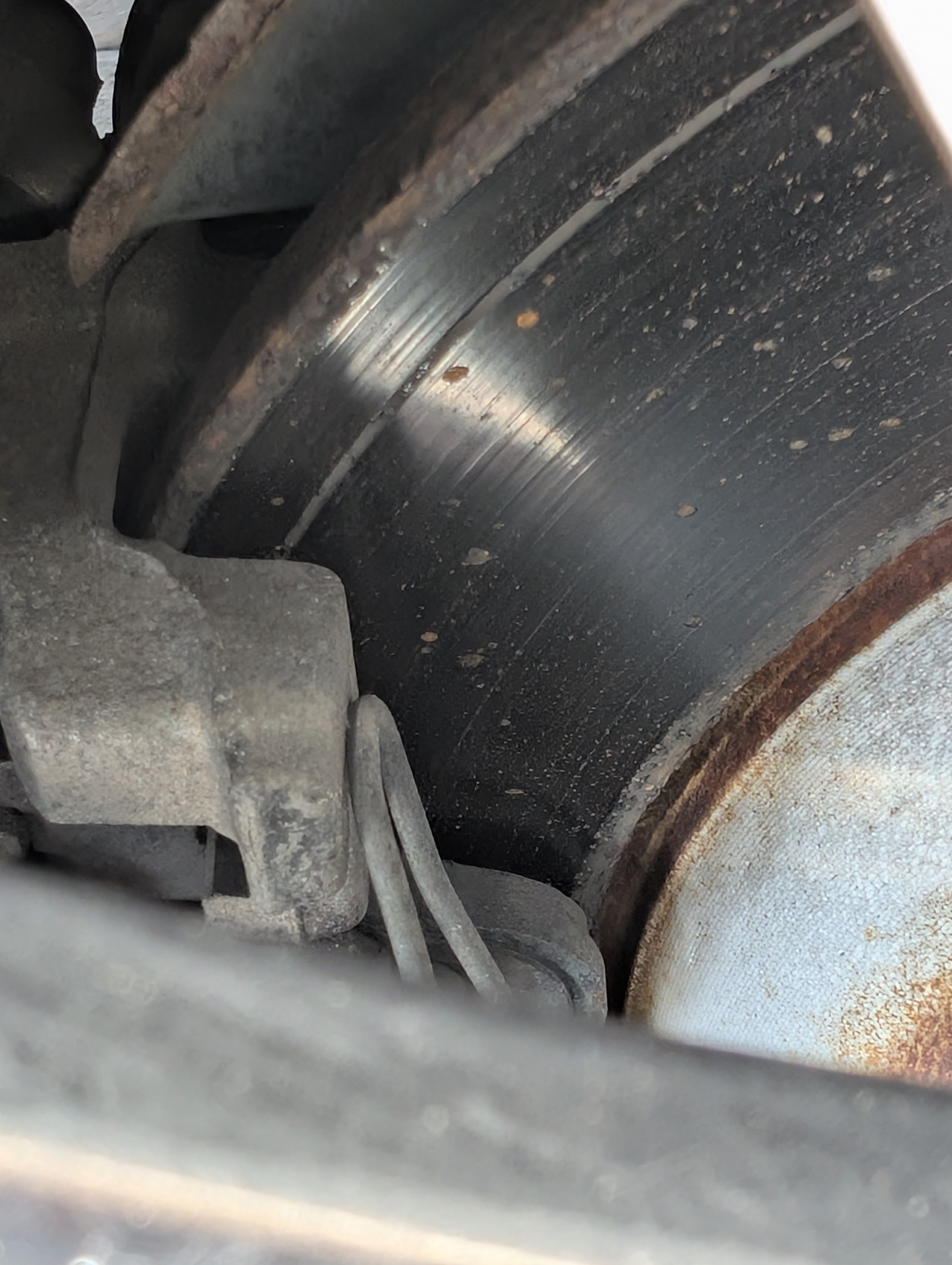

Upload a picture of your passenger side too to compared

I would think the warranty would say this is a wear & tear item. It maybe that the caliper is sticking however to prove this there would need to be an investigation which would probably cost you if found not to be.
My rear discs were far worse than yours and mentioned as an advisory on 2 MOT tests but the brake performance was good enough to pass the test on both occasions. I did finally change them along with the pads and they have since been fine.

Still looks bad but not as worse, but judging by the rust on the disc hub I guess the drivers side sees more rain when parked?
If I were you I’d change them, if you don’t have vcds etc then you’ll need to buy it or get a garage to do them as the caliper piston has to be electrically retracted.
