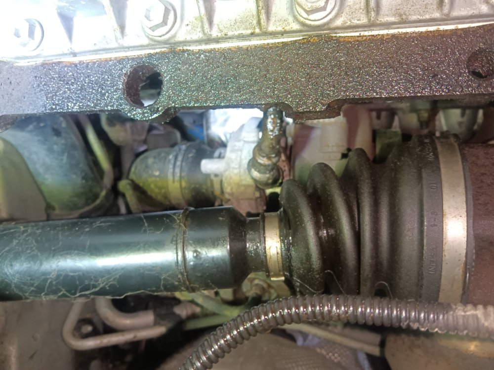

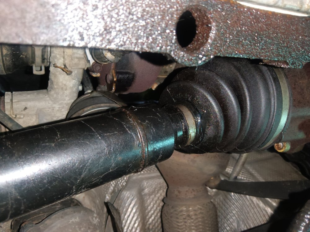

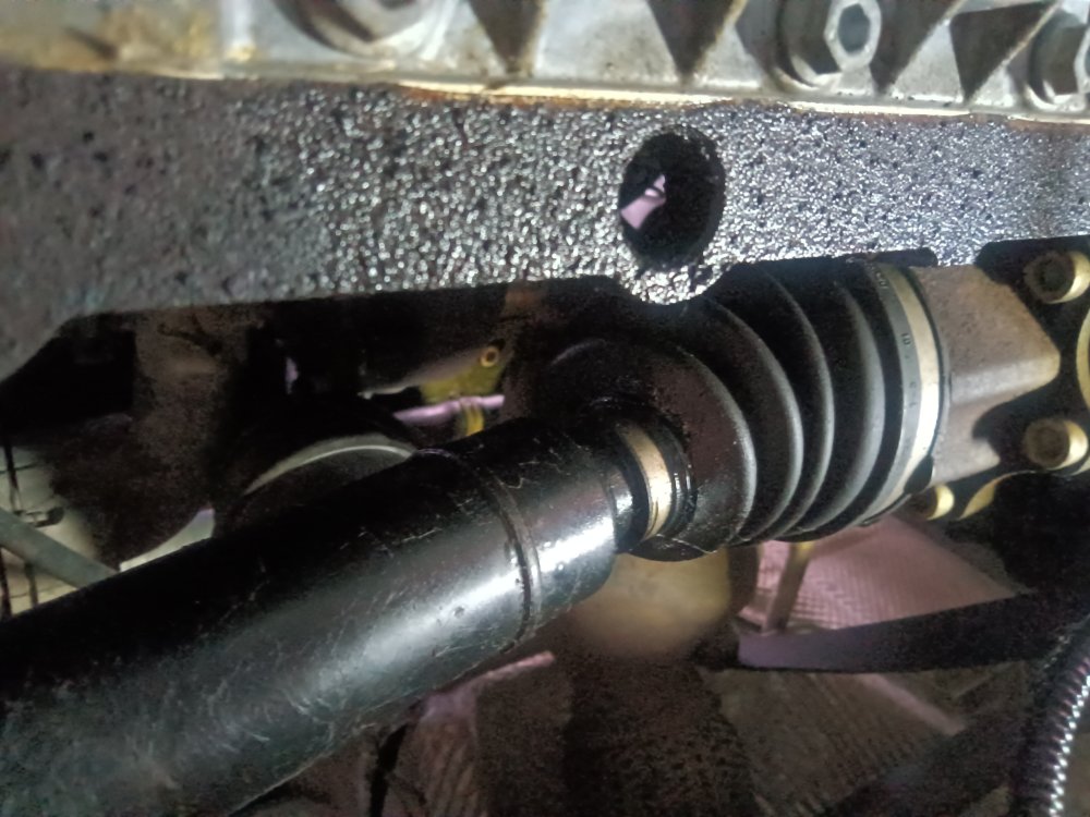

I am having the same problem with my 1.6tdi. No feeling in steeringwheel, Feel it throuh the seat and as said disappears when you stop accelerating. Have checked front suspension aand drive shafts and they are fine. Only one I havent managed to check is the bush in the subframe. Reckon its coming from rear on mine but can't work out where. First thought of wheel imbalance but nothing through steering wheel. Will be checking rear bushes etc this week. Only other time similar feeling happened on another car was due to a mishapen tyre on rear. No bulges but tyre seemed to have twisted slightly. Michelin tyre only 1/4 worn which the tyre service said they get them like that a fair bit especially when getting older. Will post if I come up with anything. Being trying to track it down for months.
Got underneath the car and the offside driveshaft is leaking oil. Probably a good indicator as to where the problem lies, but by feel, there doesn't seem to be any excessive play.
That's exactly the symptoms I'm experiencing.
My drive shafts are the same. No play at all apart from a very slight amount on drivers side if I try to turn shaft. Probably less than 0.25mm and nothing from side to side. No leaks etc.
Is yours leaking grease from the CV boot or oil from Gbox? My old Octavia had a tiny little split and covered the front end and wheel with grease. Managed to catch it before it wrecked the joint. Have noticed my wobble seems to be worse on rougher tarmac and when cornering so now thinking might be front shocks although why it only happens when accelerating??? They both seem fine with no misting of oil etc but just wondering if they may be past it but how to check is another problem.
