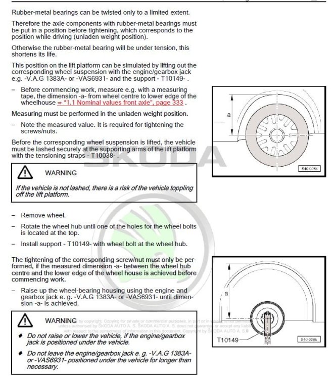

I think I may have solved this, I jacked the car up losened the bolts on the rubber bushes. Then I placed a second jack under the ball joint area and jacked the suspension up to simulate the car resting on it wheels. the rubber bush turned through about 1/4 turn and then I tightened the bolts tightened. All of this in line with Skodas recommended practice.
Looks as if the garage tighten up the bolts with the full weight of the suspension on the bushes. Therefore appling to much twist on the bashes when the car was on its wheels.

Yes after 150 miles the noise has gone, no creaks, no groans at all, its item 30 on the diagram which needs to be loosened and tightened up (70NM) with the suspension under a simulated load of an unladen vehicle. ie with a second jack under the ball joint (item 16) jack up until it just and only justs starts to lift off the main jack. Then torque up. Its a tight fit to get the torque wrench in there due to the wheel arch cover but it will flex out of the way.
Good to know, I suspect its not the end of it though, the bush is probably split or weakened, rubber to metal bonded bush should be silent even when over-rotated, they were after all trademarked Silentbloc (where both my parents worked), its only when the isolated suspension components can make metal to metal contact that you get noise.
Before anyone says anything that is not the case with non bonded anti-roll bar bushes where there is movement and hence wear between the rubber bush and the metal clamps and roll bar.
