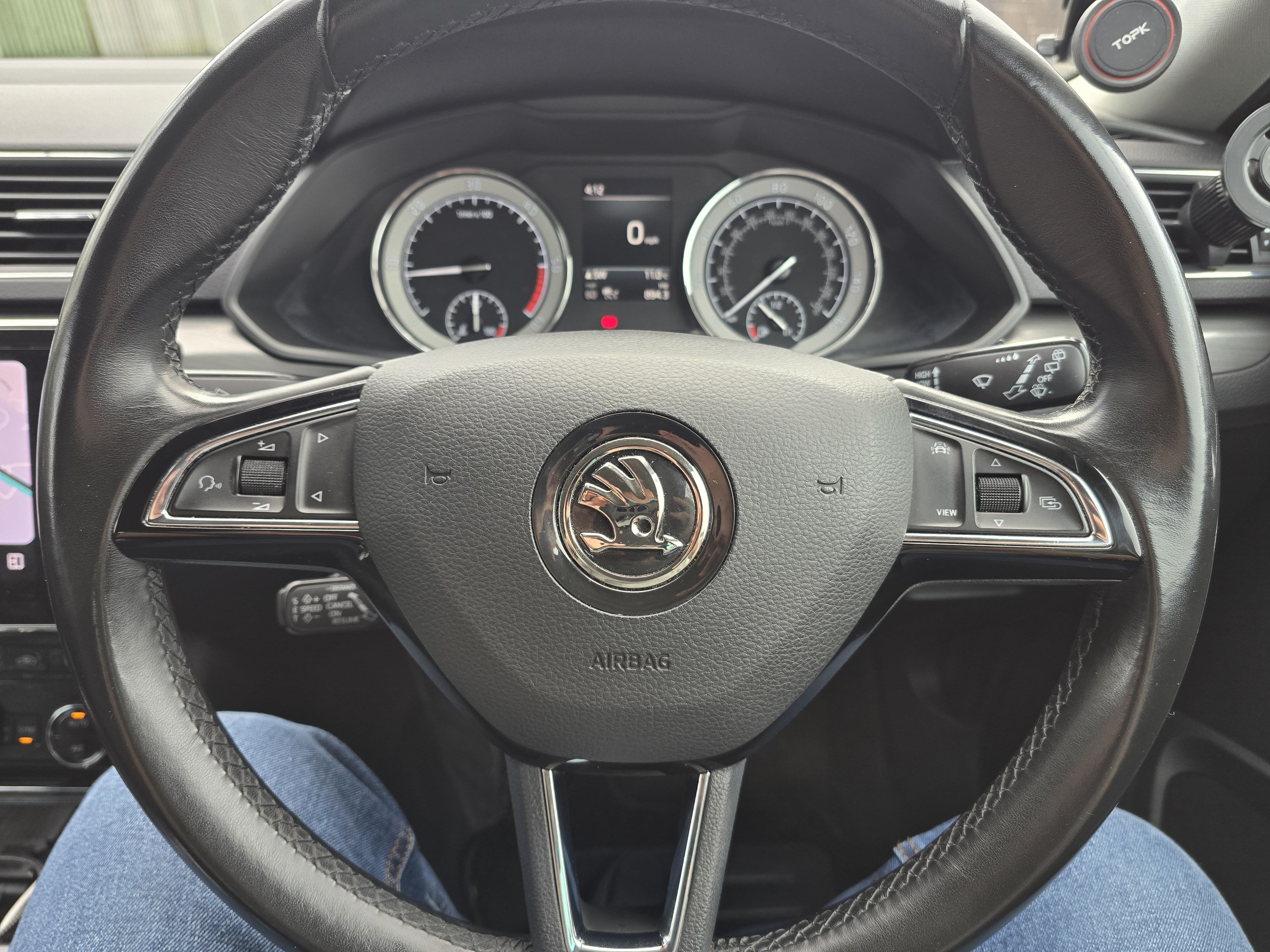

What steering wheel do you have?
I activated recently, need coding for Gateway, Radar, Camera and BCM. To turn on, you need TA button on steering wheel

Hi there and thank you for replying.
I have attached a picture of my steering wheel.
Do you have the guide you used to activate the feature? I would be extremely grateful if you can share anything with me to active the feature :)

First, you need adapter to have TA button or new steering wheel + adapter(better solution). I can help with adapter
For road signs SWaP code needed

I think the TA button is only on the facelift Superbs. My 2016 one didn’t have it, my 2023 one does. Your steering wheel looks pre-facelift? So you probably don’t need the TA button, it was kind of on by default in pre-FL. What year is your car?
Hi there, my car is a 2020 SE L model, I hope that helps

I think that puts it post-facelift? But it would depend on when the car was actually built, rather than sold I guess, as it’s close to the change. My 2023 model has a different steering wheel with heating and a separate button for travel assist, your wheel looks like my old 2016 car.
With my old car it was easy to activate traffic sign recognition via VCDS, but it didn’t really have a separate button for”travel assist” mode. It did have adaptive lane guidance which worked well.

The pre-facelift has a 3Q0 front camera, where traffic sign recognition can be activated through coding/adaptations. The authors Superb has a 2Q0 camera, which requires a SWaP code.
For reference:
The first FL versions were produced from 07.2019 to 07.2020, featuring old steering wheels but a new 2Q0 camera.
From 07.2020 onwards, they came with new steering wheels and MIB3.
The author has the first FL version, so activating TA is quite simple - it only requires a compatible steering wheel and units coding I mentioned above(in case all required units exists).
