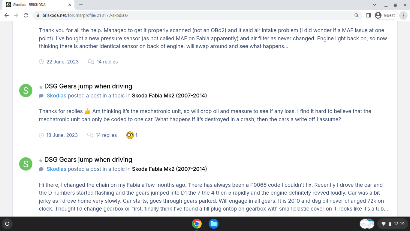

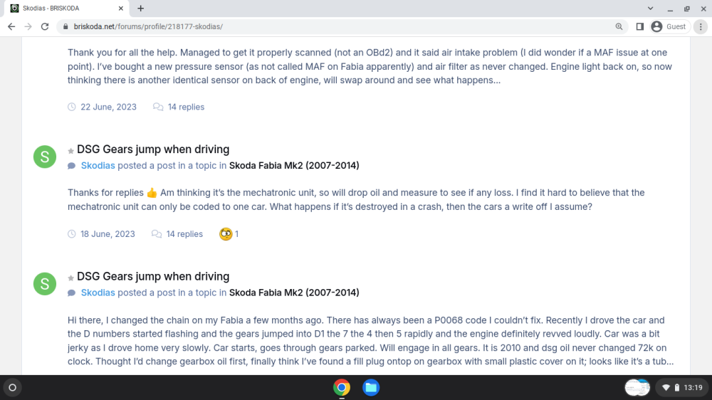

Thank you for all the replies. Got correct oil from dealers in the end. Was 75w 80.
Slippage ok for a day or two now back. RAC scanned and got PO726 code. So I guess could be crank position sensor or clutch pack. Have been advised to drive short distances and if slippage gets worse it’s clutch packs, or if intermittent or fails completely then sensor. Heard sensor is in a tough place to get to (for a change lol).
…Oil was changed after I did the chain as it stretched. 2.5 years ago. RAC chap looked at oil I changed and said it was dark but not too bad.
