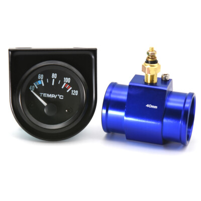

I got one from ebay years ago for an old toyota that the guage had failed. Only fitted it as the 3CTE engine was prone to overheating.
Looked a bit like this one. Not sure of the diameter of pipe on yours and where to fit it.

52mm Water Temperature Gauge 40-120℃ W/ 40mm Adaptor Join...
High sensitivity and easy operation. 1 x Water Temperature Gauge. Sensor Mounting Thread: NPT 1 / 8 ". 1 x Sensor. Numbers and pointing clearly show the water temperature. Unit: Celsius Degree. Blu...
You can also get a cylinder head temp sensor as well.

Appreciate your reply mate, ill do a bit of research to see if its viable! Its only because I'm not a fan of having no bearing of engine temperature apart from a little light that tells me when its too cold or too hot! Maybe I'm just old fashioned!
Not at all. If the temp is rising I would want to know as if it gets to the point an alarm or light comes on and you can't find a safe place to stop its not good. The old Toyota lucida I had had the temp sensor at front of engine but rear was always hotter so if it overheated they were prone to cracking cylinder heads between the valves. I also had an extra alarm that told me if the temp was rising quickly as the guage tended to show a lower temp than it was and was very slow to react. Never had a car without one.
