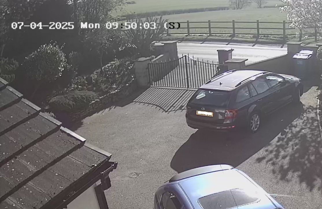

Now, thinking about the tyre, I hadn't parked in my usual spot on Sunday, as I'd needed access to the driveway. Where I parked meant that the LH rear tyre was in full sun for a couple of hours on Monday morning.
My thinking is that the pressure in that tyre increased due to the heat and then was reducing slowly as I drove. Feasible?
