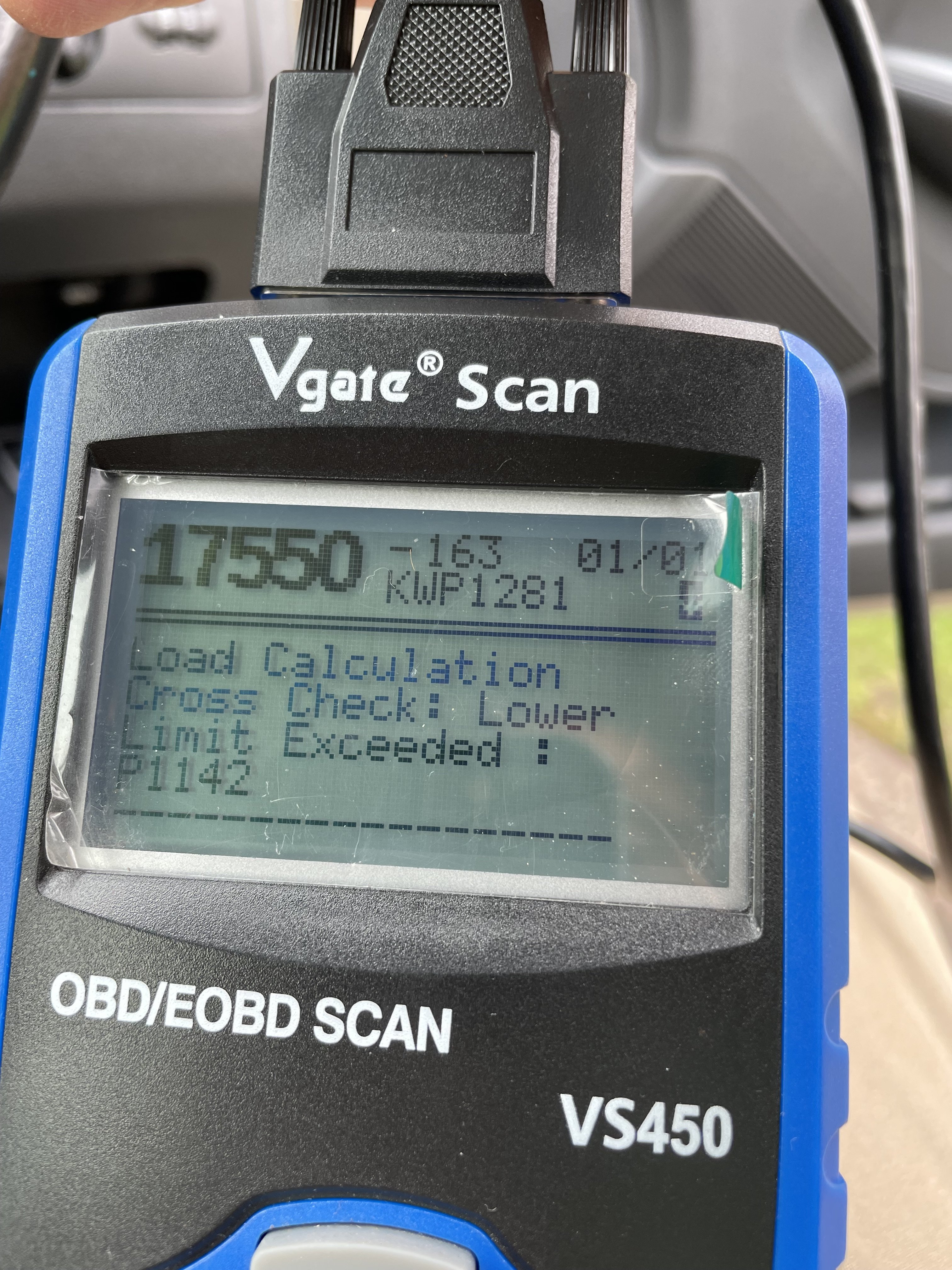

For some time now, at random my Fabia 1.4 BBZ displays lights on the dash and when scanned reveals fault code P1142.

This is the trouble with this code, there are a number of options, listed as you said. The one guarantee is that it isn’t the MAF as it has not got one!!
