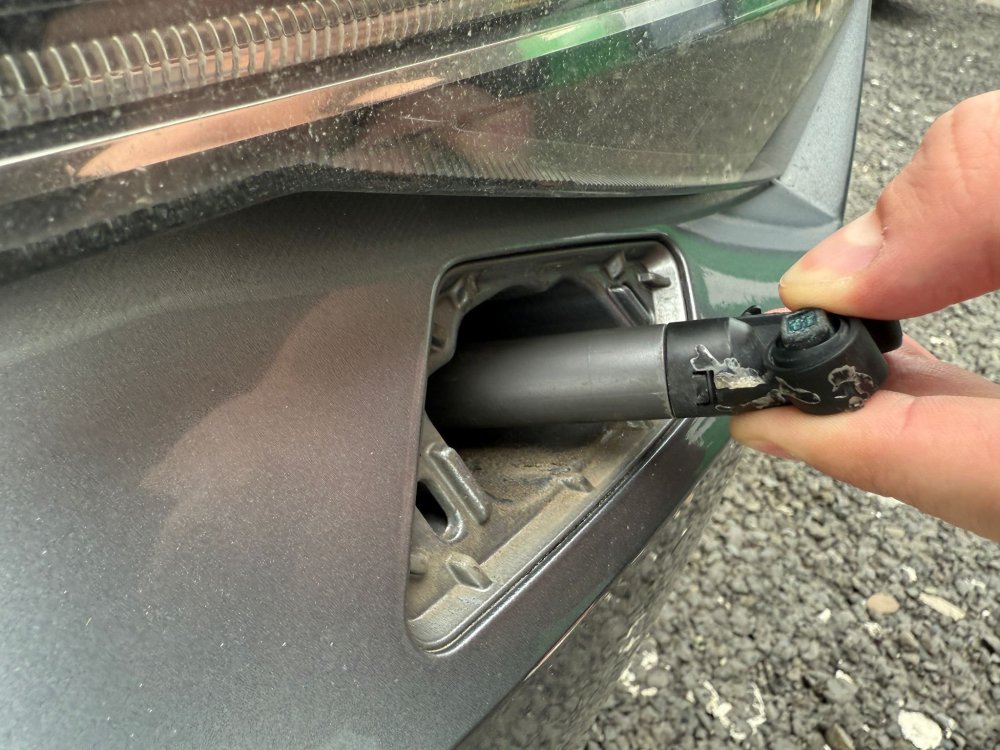

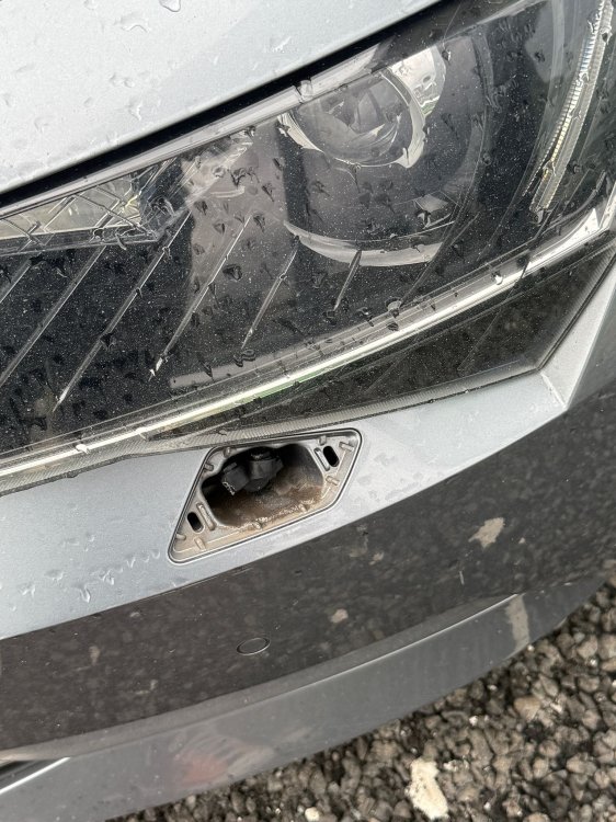

I have a skoda superb 3 and recently I found a problem. In the morning I found that my headlight washer cover is missing ( I think some one stole it :D ) . The headlight washer ( the cover and the fixing component ) need to be replaced. To do this do I need to uninstall the front bumper and headlight? or there is another way from underneath.
I will post a picture with the broken headlight washer. Any advice?

U need to remove the front bumper in order to fix or replace the headlight washer.
No need to touch or remove the headlight.
A while ago I made a how to guide on removing the bumper.
Essentially it's not a simple job, but doable.

Shouldn’t be any need to remove bumper, watch these
Then this at 14:45 ish
