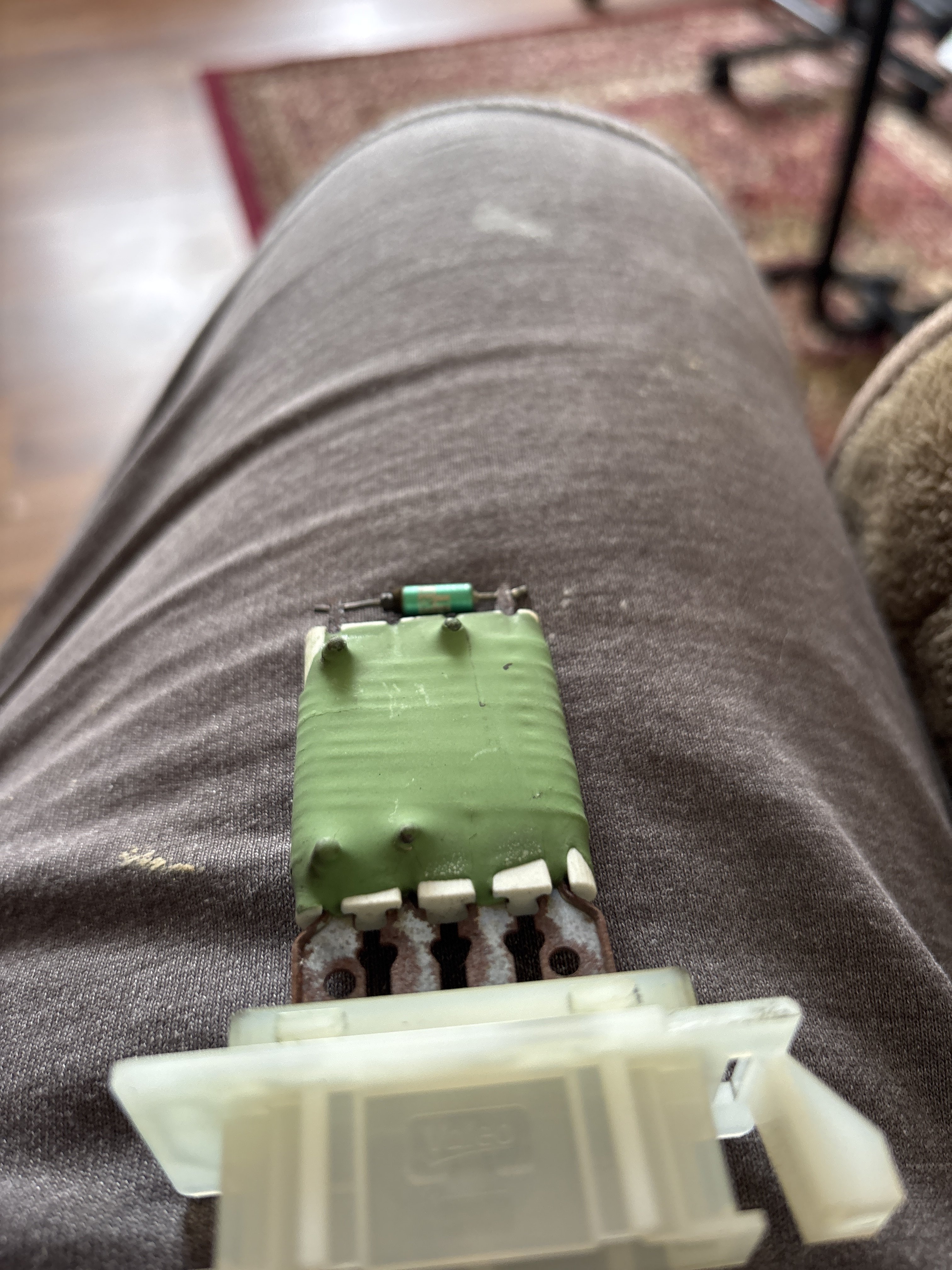

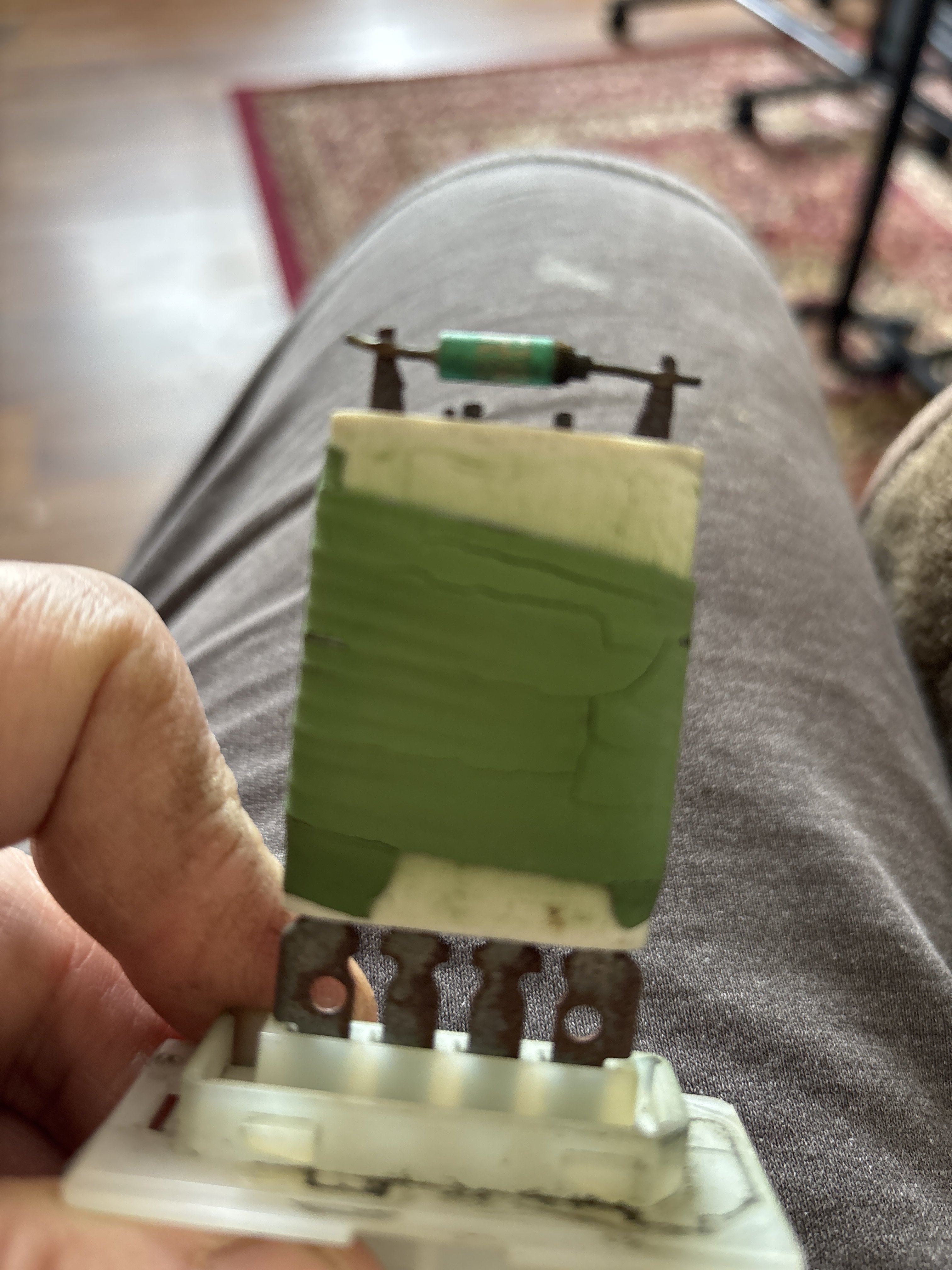

Just taken a very old , rusty and crusty original one out
Very easy to reach
Just waiting for Amazon now for the new 1
Edited by Redestate
New one delivered and fitted , and now heater blower works on no1
