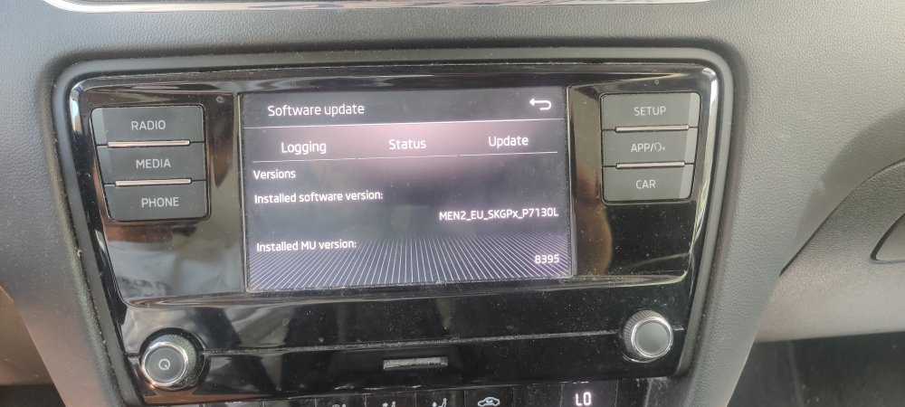

I wanted to share some details about my infotainment unit and ask for your insights. I'm a software developer and currently exploring how to enable MirrorLink on my Škoda system – but I’ve hit a roadblock: it seems I need access to the green engineering menu first.
📟 My Unit Info:
Version: MEN2_EU_SKGPx_P7130L
MU version:8395
Menu Access: I currently have access to the Engineering Testmode (accessible through hidden menus).

You need a way to access the infotainment and change a flag that allows you to enter the GEM.
So AFAIK, no. You need to access the car's OBD. I did it with veepeak obd2 dongle and carscanner app on android.
That's about 30 quid on amazon and you'll be able to read other faults if it happens to your car and also mod some functionalities.
Obd11 is probably more user friendly but also more expensive.
Do you mean the Development mode?
GEM = green engineering menu
