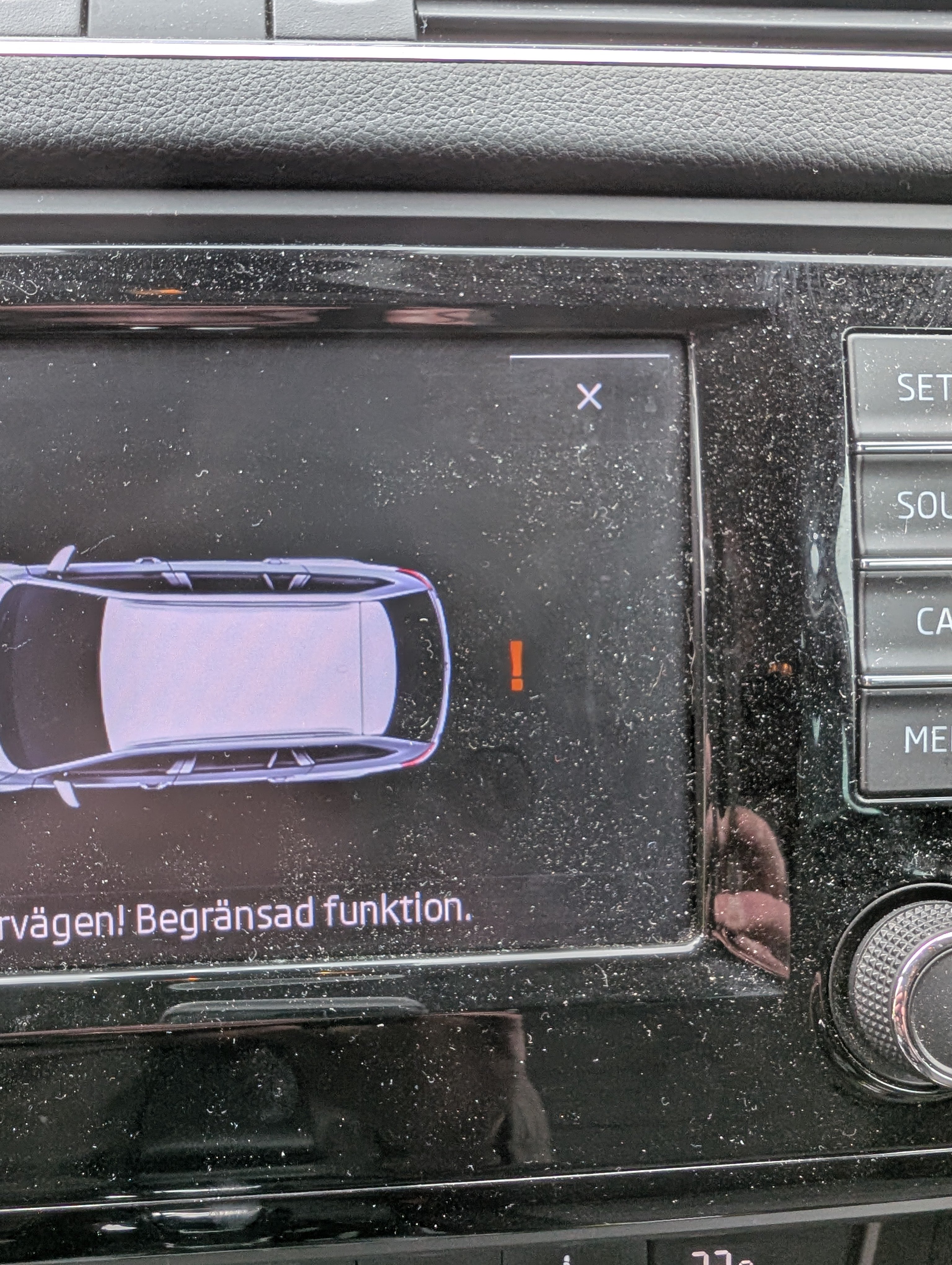

I have suddenly got an error with my parking sensors on my octavia 2016
When put into gear an alarm sounds and the picture on display is attached image.
Since the exclamation mark is shown on the rear of car i guess problem is with the rear sensors.

It happened to me, a sensor had been stained with resin
