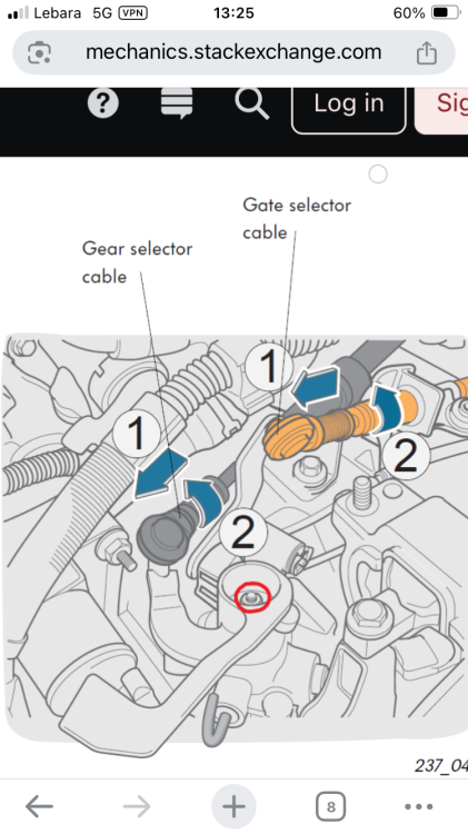

Follow the gear selectors to gearbox detach from the lever. Take that 2 or 1 pin bit of metal just under the 2 pictured in below. Clean shaft and where it inserts and grease inside and reassemble. Helped solve my MK2 octy and Fab Mk1 gear selection issues. Of course you could also readjust cables procedure on YouTube.
Ps is the number 2 under where the orange selector cable is just above where the red circle is on this example picture.
